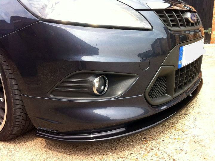

Hi lenny these ar the ones I'm on about
Hi mate,
I don't have access to those clips because I've fitted a tripleRcomposites splitter on to the front lip,
I can't physically remove the clips, the splitter is pop rivet to the lip
The two outer clips are in your bumper already,
The only one extra is the middle one, and it comes with the front lip from ford.
The adhesive is seperate but not sold along with the clips
#323 yunii
yunii
    yunii
  • True Ford Enthusiast
  • 511 posts
  • Name: yunii (nickname)
  • Ford Model: FOCUS TITANIUM-S
  • Location: Yorkshire
Posted 09 January 2014 - 10:05 PM
I can use tiger seal & maybe theirs this plastic rivet still in the skirt I cant remember or had a close look ,also wrapped it up for storage for protection. Also bodyshop say can use rivet or some screw or think of something.
Sent from my HTC Sensation XE with Beats Audio Z715e using Ford OC mobile app
#324 Lenny
    Retired Moderator
  • 8,609 posts
  • Ford Model: Focus ZetecS
Posted 10 January 2014 - 06:53 AM
I can use tiger seal & maybe theirs this plastic rivet still in the skirt I cant remember or had a close look ,also wrapped it up for storage for protection. Also bodyshop say can use rivet or some screw or think of something.Sent from my HTC Sensation XE with Beats Audio Z715e using Ford OC mobile app
Rivet would be better and a stronger hold mate,
If you fit a TripleRcomposites front splitter on to the zetecS front lip;
The centre spine of the splitter has a hole in the centre of it... that hole lines up with the centre hole on the Zs front lip.
The Zs plastic clip gets removed,
Anda stainless steel M6 lock nut and bolt replace it,
The bolt goes through the splitter, lip and bumper gripping it all together.
This design of fitting also ensures the splitter is perfectly centre on the car because it has a centre spine that fits the centre slot set there by ford design.
So a metal rivet or fit a tripplercomposites front splitter

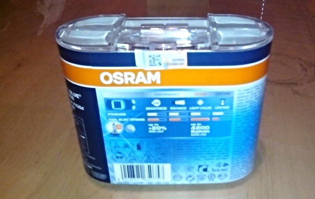

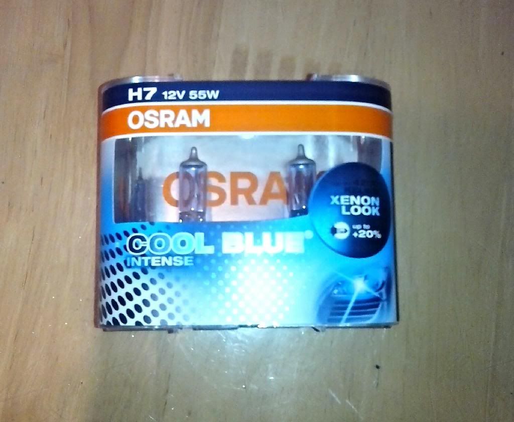

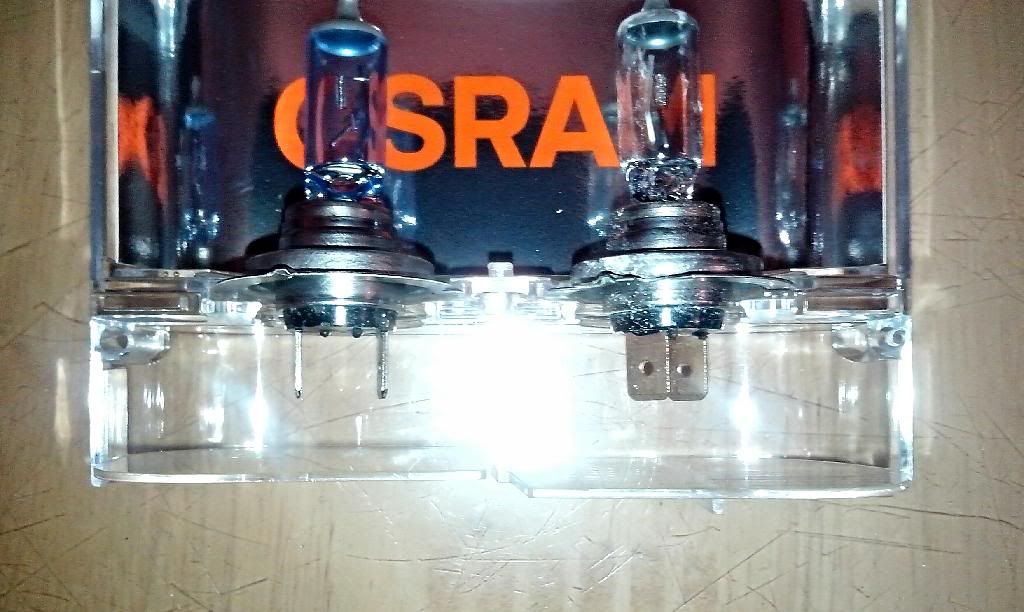

Update:
Osram Cool blue intence low beam H7 4200kelvin bulbs arrived today,
IMG_20140113_101438_zpszxvcrny_edit_1389
IMG_20140113_101448_zpstryol5r_edit_1389
Going out now to fit them,
I'll update later with some pictures

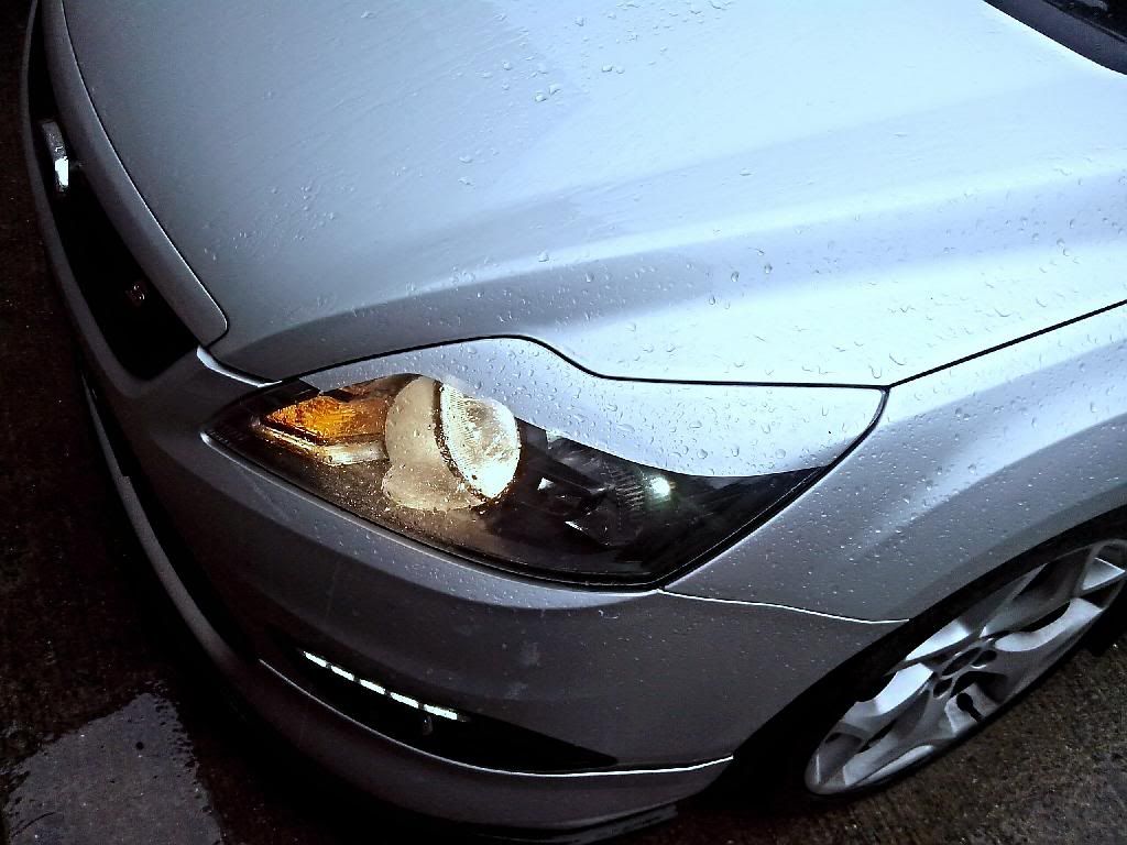

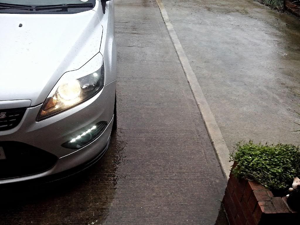

Osram cool blue intense now fitted,
The image below is cool blue on the left unit and osram night breaker plus on the right unit
IMG_20140113_102925_zps5q9pdbq_edit_1389
And again,
Cool blue intense in the left unit and nightbreaker plus in the right unit.
IMG_20140113_102515_zpsayc3dfo_edit_1389
Now with osram cool blue intense in both units
IMG_20140113_103716_zpscbeldyj_edit_1389
IMG_20140113_103707_zpsoyvk71j_edit_1389

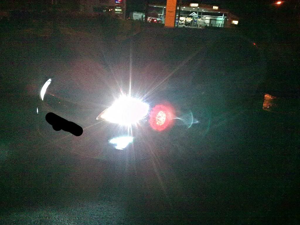

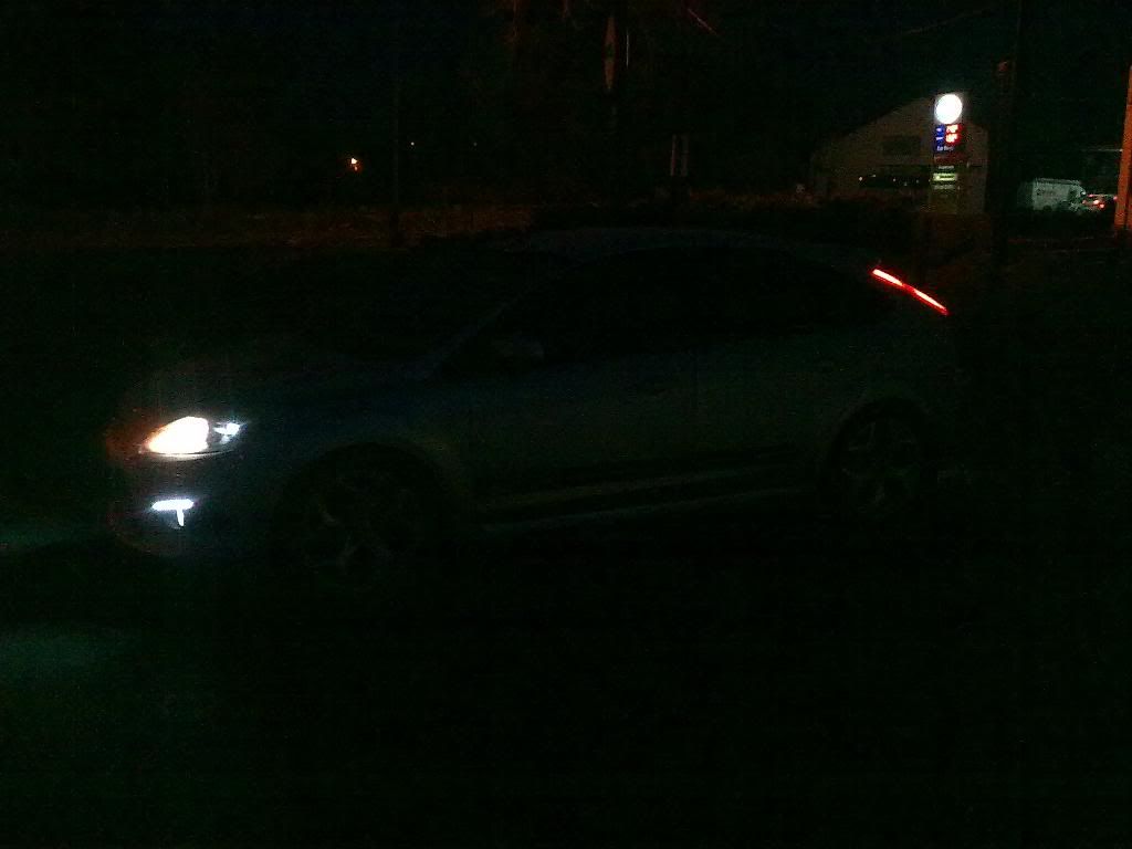

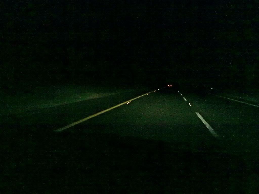

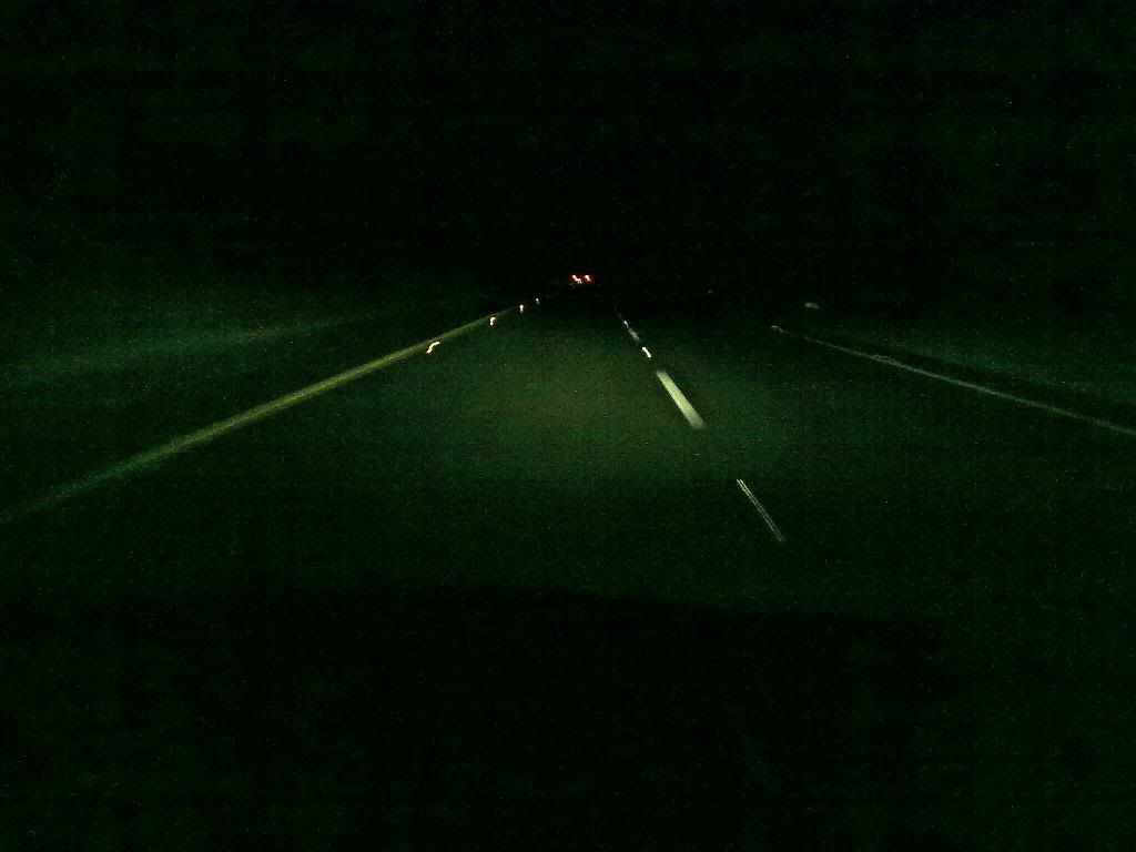

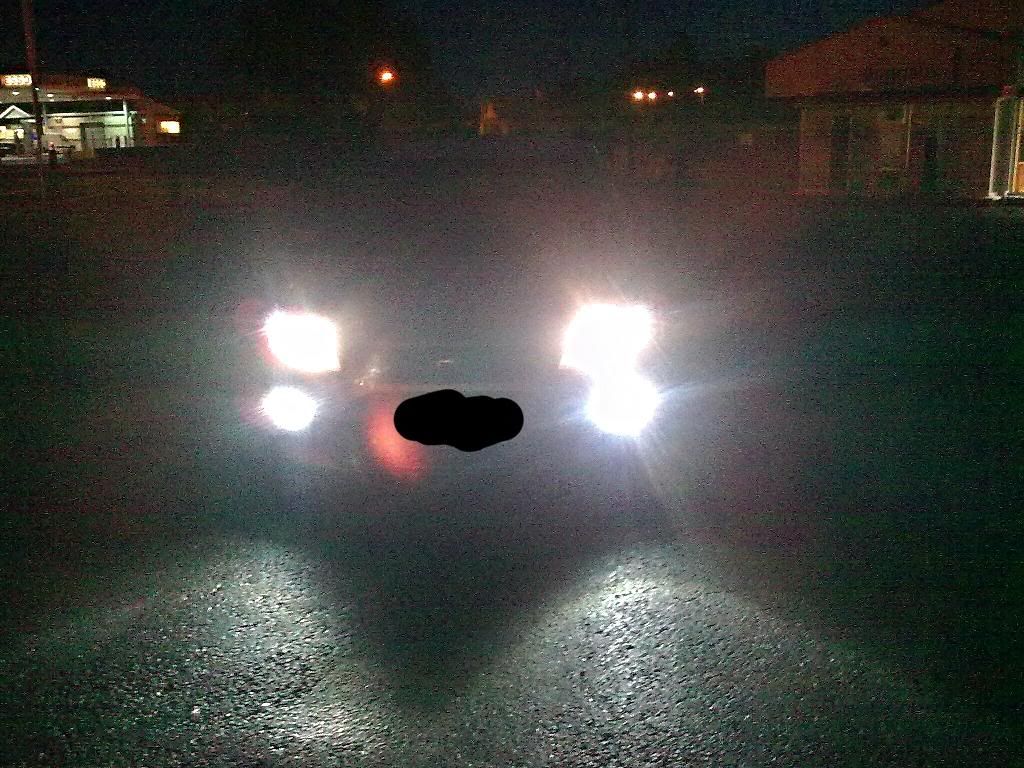

Took these pictures at 07:23 this morning
Both on the road and in lidil car park with Toyota in the background ;)
And a picture of them agents a white wall in lidil car park to show there's no yellow shining on the wall.
This is Cree H11 led fogs
T10 led parking bulbs,
Osram Dipped DRLs
And the osram cool blue intense
Image4064_zpstzg96ew_edit_1389687022789_
Image4065_zpsizpobhn_edit_1389686832362_
Image4068_zpsx4krqmj_edit_1389686940073_
Image4066_zpsc4ngjzr_edit_1389686727678_
Image4067_zpspzzuujq_edit_1389686458340_
Image4070_zpscwqivne_edit_1389686381132_

Posted 14 January 2014 - 02:07 PM
Nice Lenny, so would you recommend the cool blue intense as a road legal white/xenon look replacement for dipped bulbs. They certainly look good. I like my philips diamond vision, but obviously not road legal and would definitely fail an MOT. And having to take them out before any servicing/mot etc is just plain annoying
Also the cree H11 fogs, do you have any links for the ones you bought, as I got these ones http://www.ebay.co.u...984.m1439.l2649 thinking they were from a UK supplier, only to find they came from China and the drivers side one has blown after less than 24hours.
I'm tempted to just get some of these halogen bulbs for a white look http://www.ebay.co.u...=item19bea28fb1
#330 Aldoo
Aldoo
  • Budding Enthusiast
  • 217 posts
  • Name: Tom
  • Ford Model: 1.8 TDCI Focus Sport
  • Year: 2006
  • Location: Durham
Posted 14 January 2014 - 03:00 PM
I had osram cool blue for about a year, i replaced them with the Philips blues when they blew
IMO id go for the osrams, they're the whitest light when you're driving, but have a bluer look when you look at them :)
Sent from my GT-I9070 using Ford OC mobile app
