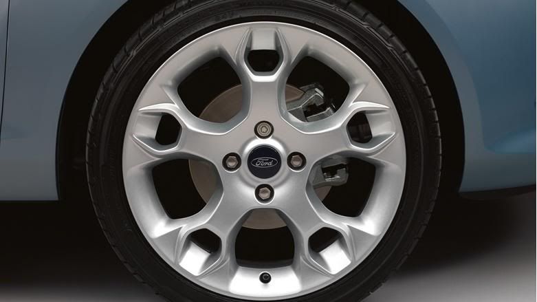

I have seen a few people on here have added custom wheels to the new ford fiesta (09+) and was wondering if you could tell me what offset etc I would need to know... also where you got your rims from / what size / how much £££ etc. Any useful info will be appriciated
This is just an afterthought, after seeing the Mountune with the black rims. Sweeet. I would go for that but i NEED (yes, im a geek) all the extra kit such as blue tooth, auto headlights and cruise control which you get as standard with the titanium.
I have a Zetec MK7, and wanted the Titanium X 17" alloys, was quoted £800+ for the tyres, fitting and alloys from my dealer and told it would void my varrenty if anything happened related to the wheels. If I were you I'd just get the X pack
void warranty, hahaha they do try it on... I got the genuine Ford fittment 17" wheels from somewhere other than my dealer, cos they'd only sell me them as part of X pack due to demand. I'd like to see them win a warranty dispute with those in a court.
17"s have 205/40/17 tyres on the mk7, with the regular fiesta offset and pcd.

If you fit costum wheels to it, 17x7 offset 38 and up will be no problem at all! - 18x7 offset 38 and up should also be fine... but remember that tyres in 205-215/35 R18 is not so easy to find in a good quality without they are pretty expensive, due to the "odd" size!
I belive that a 17x7,5 or 18x7,5 with a offset of 40 or higher will be ok as well... but if you go for a offset of 40, I would be a little cautious with a heavy lowering of the car! ;)
