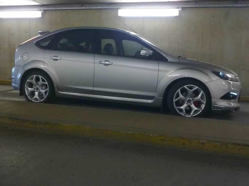

I personally think the eibach kit will be low enough considering the existing ride height with 18" fitted
this is before lowering:

After lowering
I'm looking at upgrading the rear anti-roll bar to a bigger diameter one from "whiteline"
I've spoke to an ST driver who has one fitted and says the steering is more predictable and precise.
For 150pounds its well worth the try plus its supplied with polyurataine bushes.
I'll update on the 10th May with images and review.
