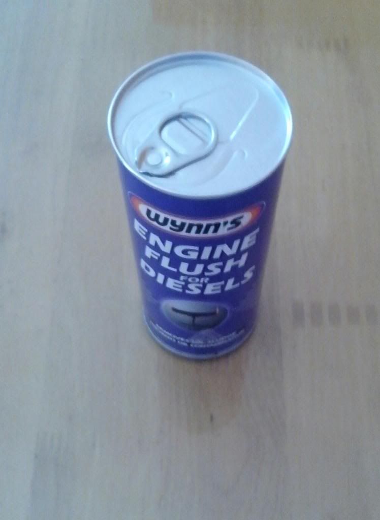

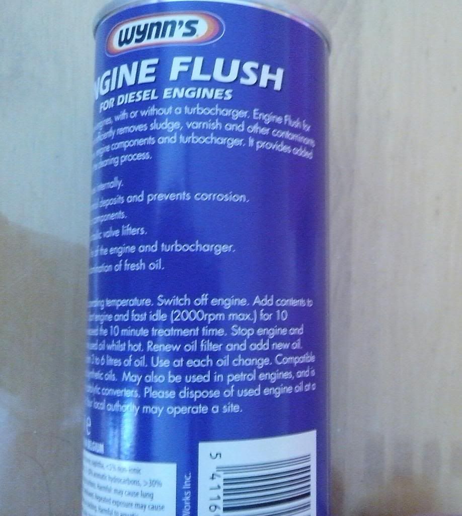

So after you have blanked/Deleted the EGR valve, i recommend using a Can of "Wynne's Engine Flush" on your next oil change,
The can costs less than 5 GBP
It breaks down the built up carbon and sludge inside the engine caused by the operations of the EGR,
I've used Wynne's engine flush many times and found it very effective, always follow instructions.
Here's a link: http://www.halfords....or-diesel-425ml
