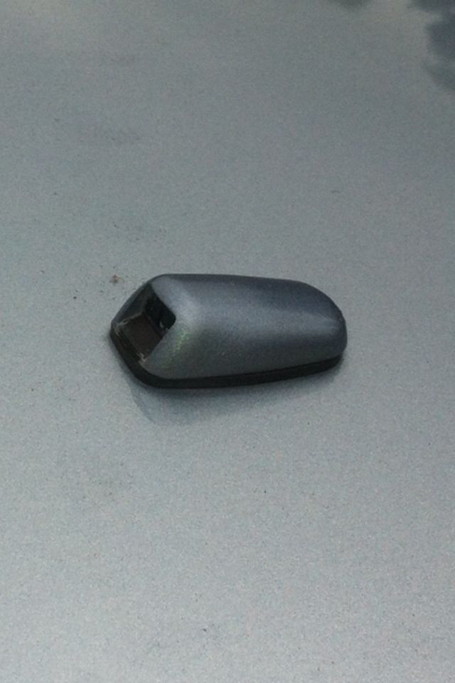

I colour coded mine. It takes time but well worth it.
You'll need sandpaper, plastic primer, your preferred colour and lacquer / clear coat.

Take your time and do it like willy says.... Here's mine, not the best pic but I'm proud to show my handy work, if I had LEDs I'd be ashamed lol

Aye mate you can paint the mist jets, mines and looks like willy's are mists too. Take your time doing lots of prep.... I sanded my jet housing to give the primer a good key to adhere, build up thin coats of primer sanding lightly with 1200grade wet n dry then same with your colour.... Building up thin layers sanding between coats, then the lacquer. I'm sure I did four coats of everything. Just cos its a tiny piece to paint, don't rush it or it will end up looking crap, and the paint will most likely crack.
