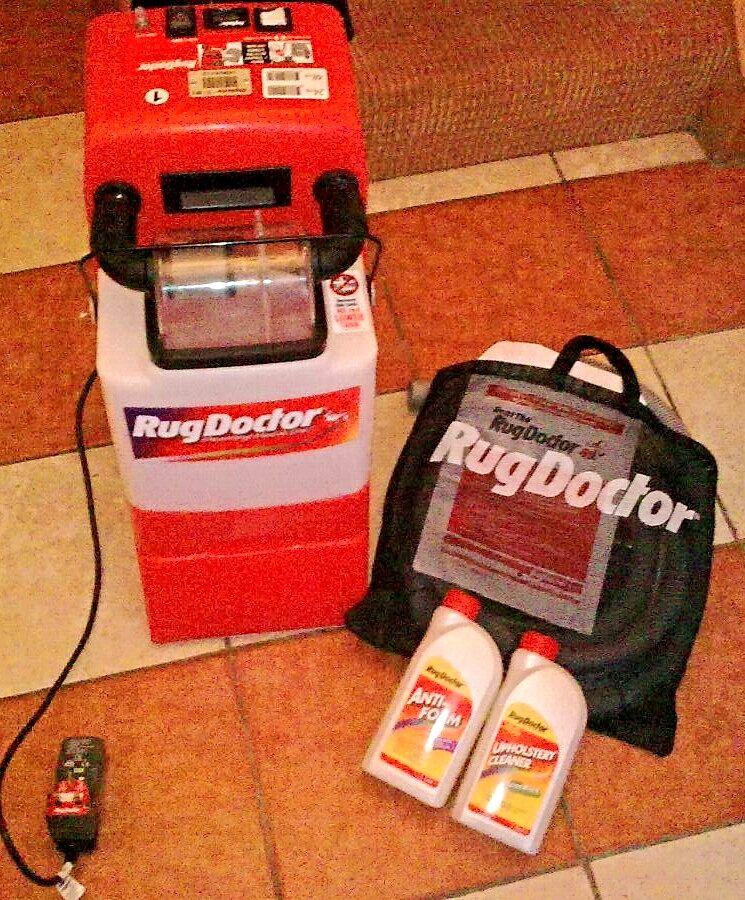

I've been to tesco and collected the Rug doctor aswell as purchasing a bottle of rug doctor upholstery cleaner and the essential bottle of anti-foam liquid,
Both together cost 12 euro but essential to operate the machine with results,
So here it is:
The electrical cable it actually very long at around 5 metres,
It can't be seen I full in the above image because its wrapped around the adjustable handle on the rear of the unit.

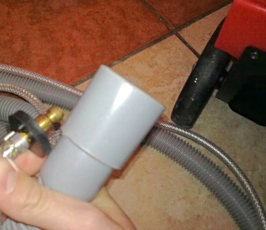

To use the handheld attachment,
You need to first unplug the standard base cleaner pipes and plug in the hand held instead,

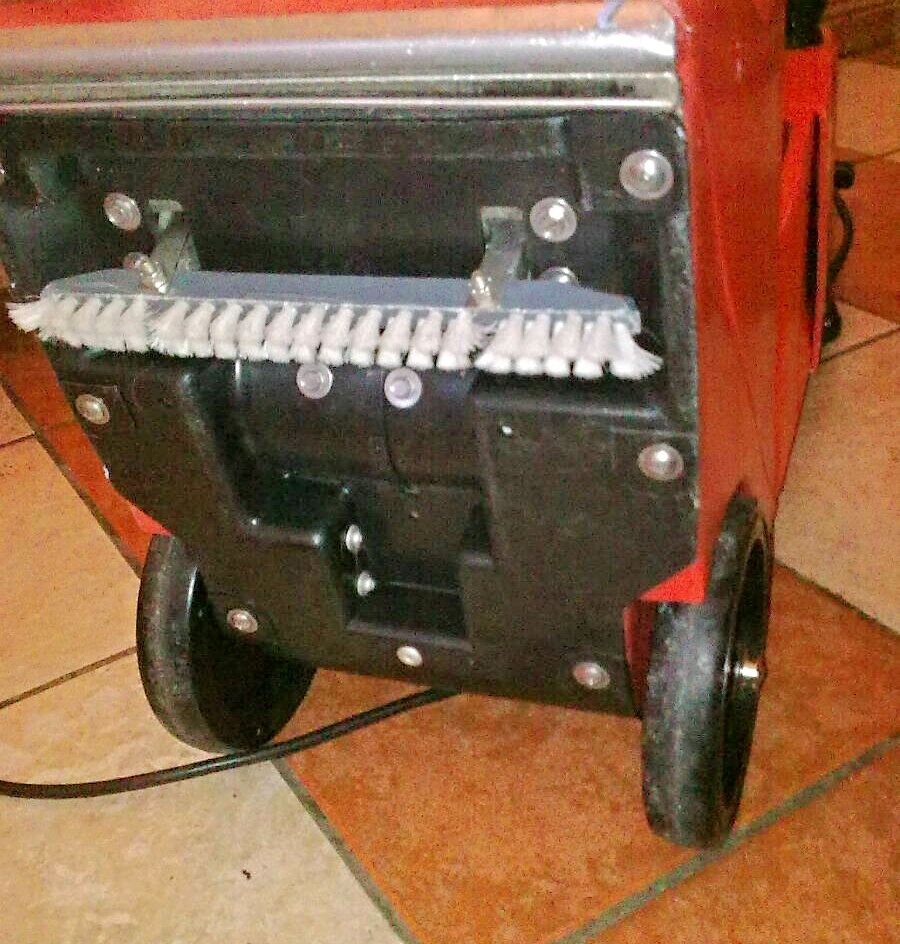

As you can see in the image below,
The underside of the unit is designed for wheeling along carpet floors to cleaning.
This option is disconnected when using the hand held device.

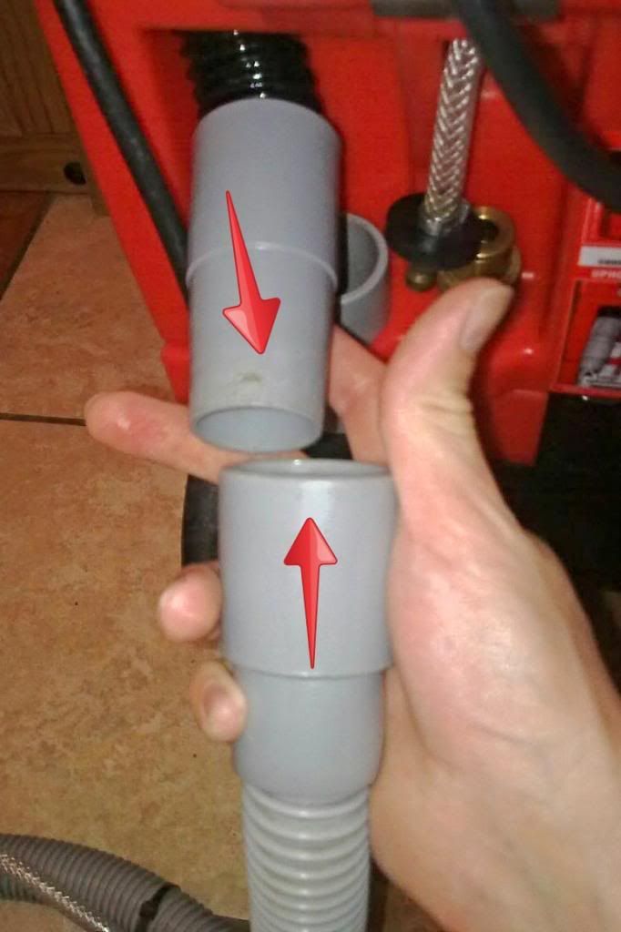

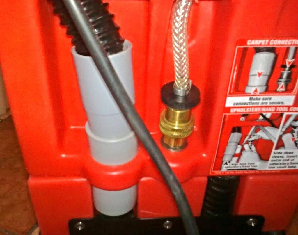

So let's disconnect the feeds going to the base and plug in the hand held.
Here are the feeds going down to the base,

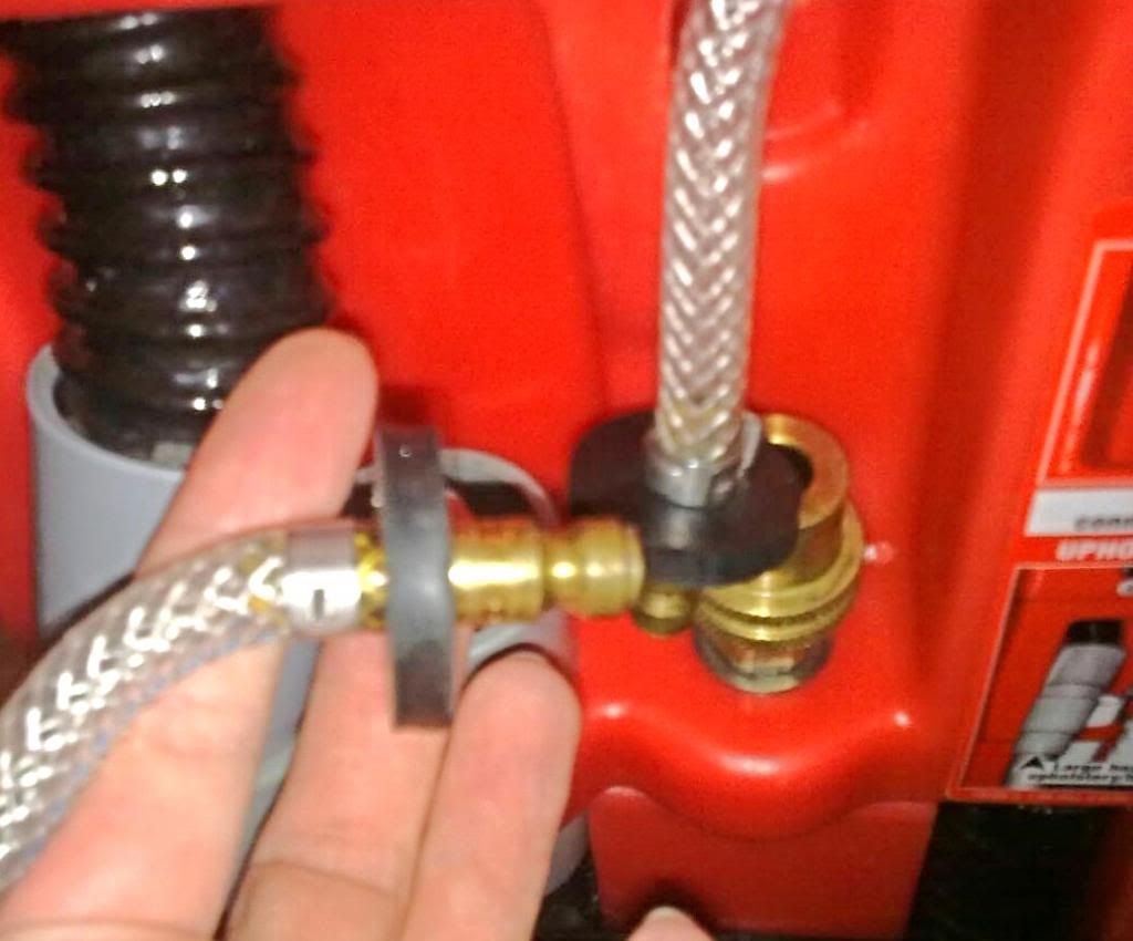

Unplug both of these and connect hand held instead,
Now connected,

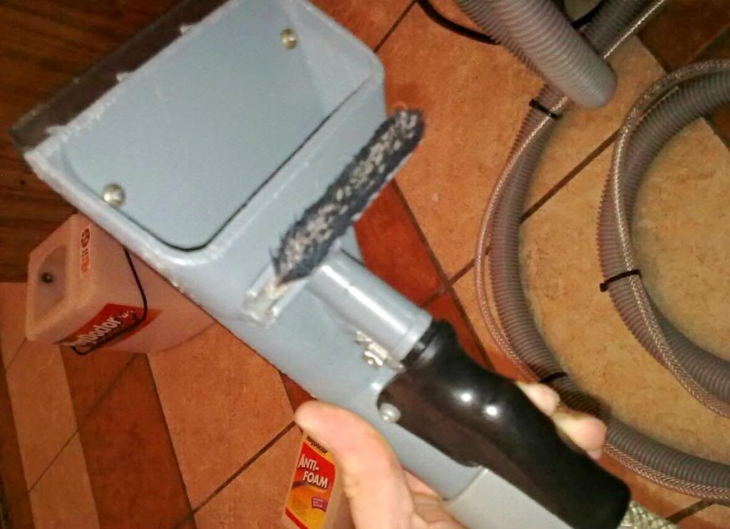

There is a black handle trigger,
This controls the dose of cleaning liquid being injected in to the upholstery,
If you don't pull the trigger you can vacuum the existing liquid that has been applied.

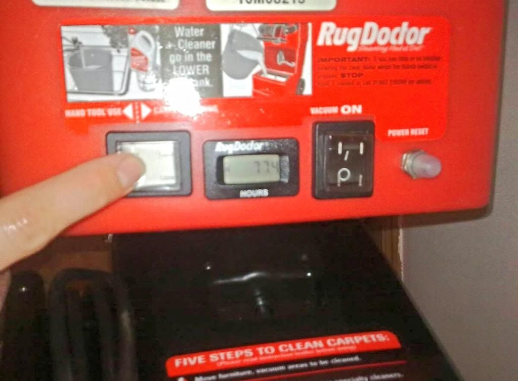

Once you have connected the handheld unit,
Press the white switch to handheld on the top of the machine,
Otherwise water will leak in the floor

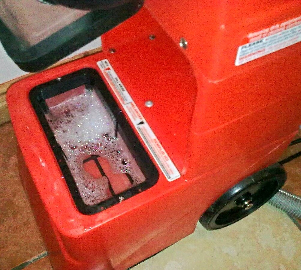

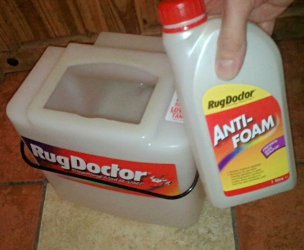

Next step

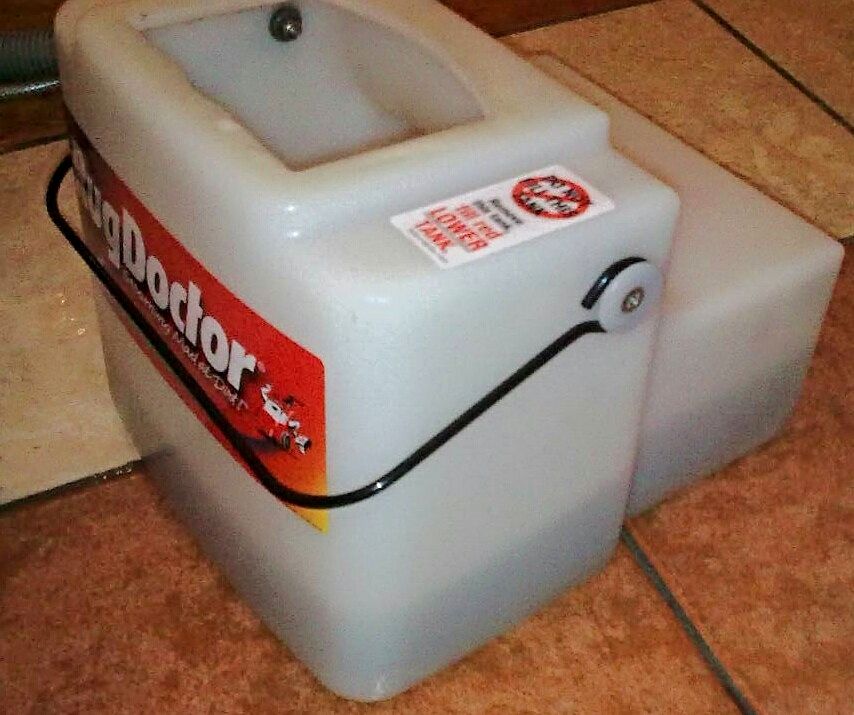

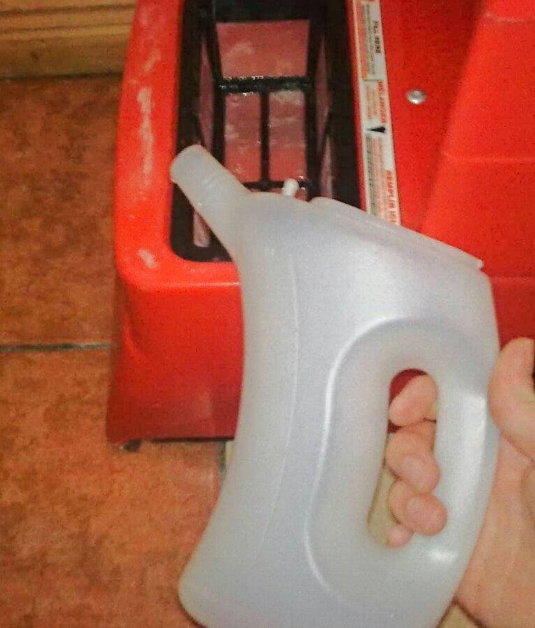

Pour 50ml of anti-foam solution in to the collection tank,
Do not add water to the collection tank, just add anti-foam

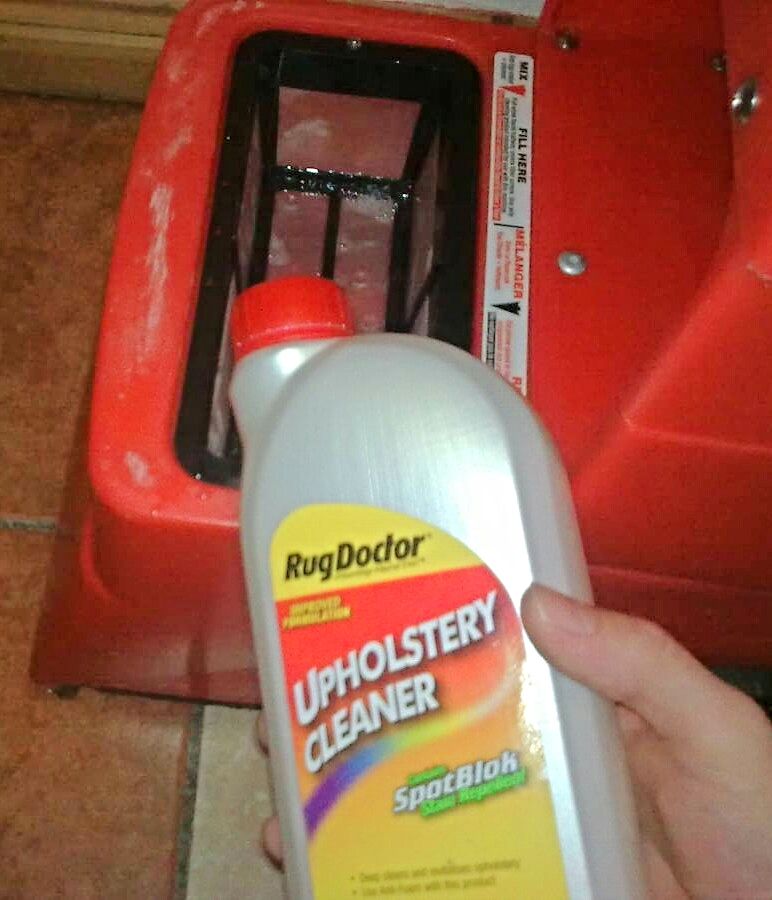

Next step,
pour in 500ml of upholstery cleaner in to the red base container,
Followed by measuring in a further 8 litres of warm NOT boiling hot water ;)

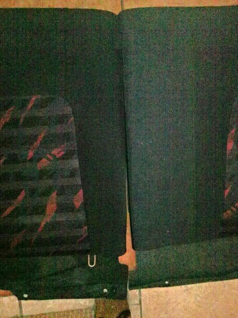

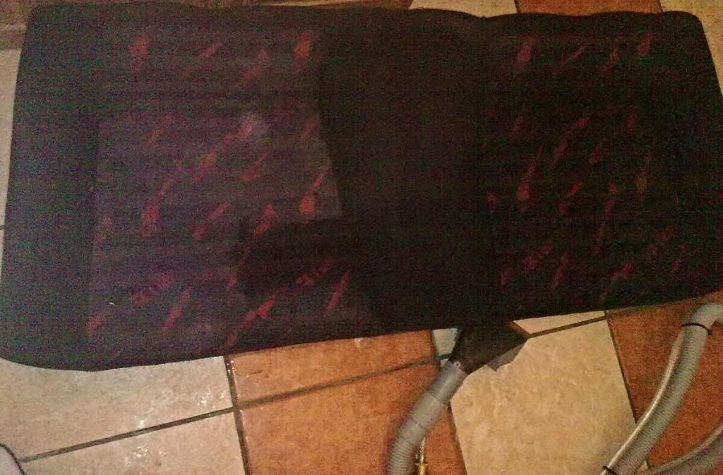

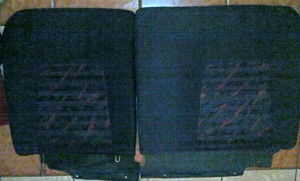

OK not a great picture this one,
But the section of rear seat on the left has just been done with the rug doctor,
Compared to the section on the right that hasent.
Seems to have restored some fade in colour,
The seats feel softer too and smell pleasent, but not over powering like ferbreeze.

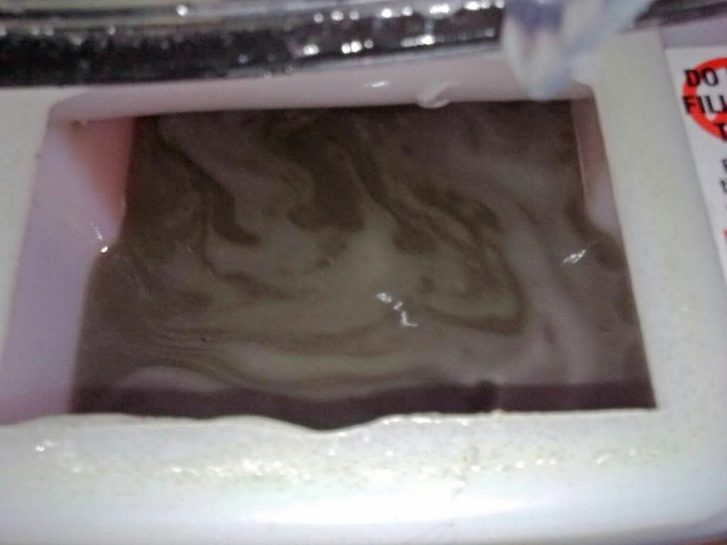

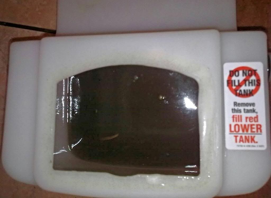

Here is how much dirt came out of that one back section of the rear seat...

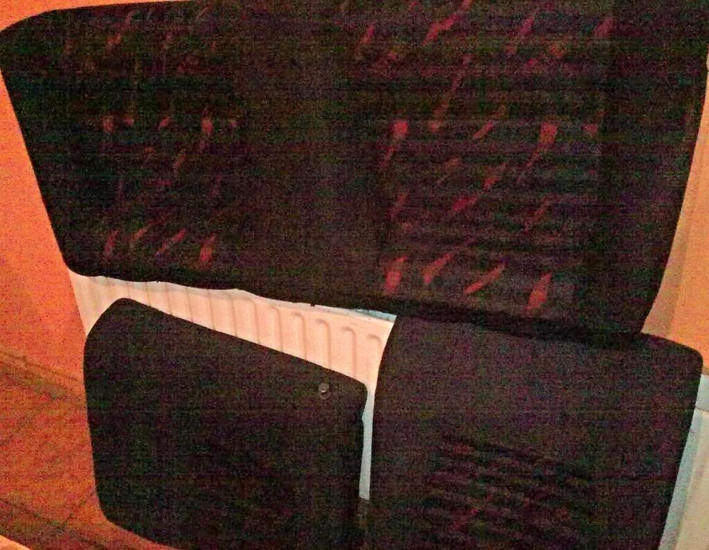

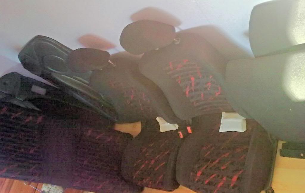

Complete rear seat now done,
I stacked them on the kitchen radiator overnight to completely dry,
The rug doctor has excellent vacuum, and you can see the dirt lifting through the pours in the cloth,
But the seats remain slightly damp afterwards,
As result require son drying time.

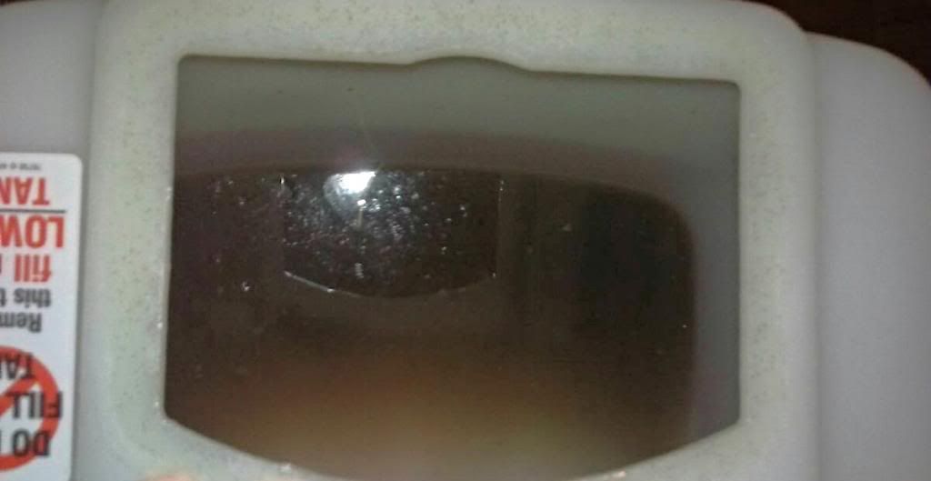

Again,
Here is the dirt collected from the entire rear seat.
Quite a bit,
I emptied out the collection bucket prior to starting to clean the front passenger seat,

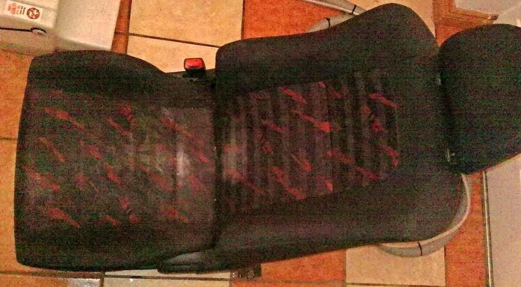

The white stain on the centre of the seat is talc powder from my daughters, sitting on the seat pretending to drive after bath time :lol:
Here is the dirt collected from the front passenger seat only.

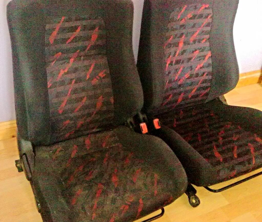

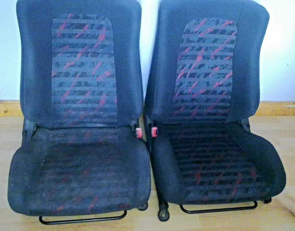

Below is an image of the passenger seat after cleaning,
On the right hand side,
And on the left is the untouched drivers seat,
You can really see the difference its made

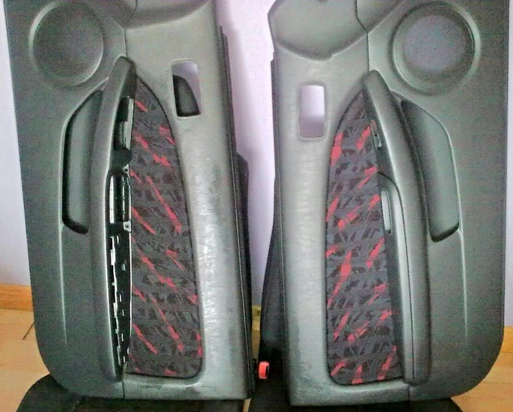

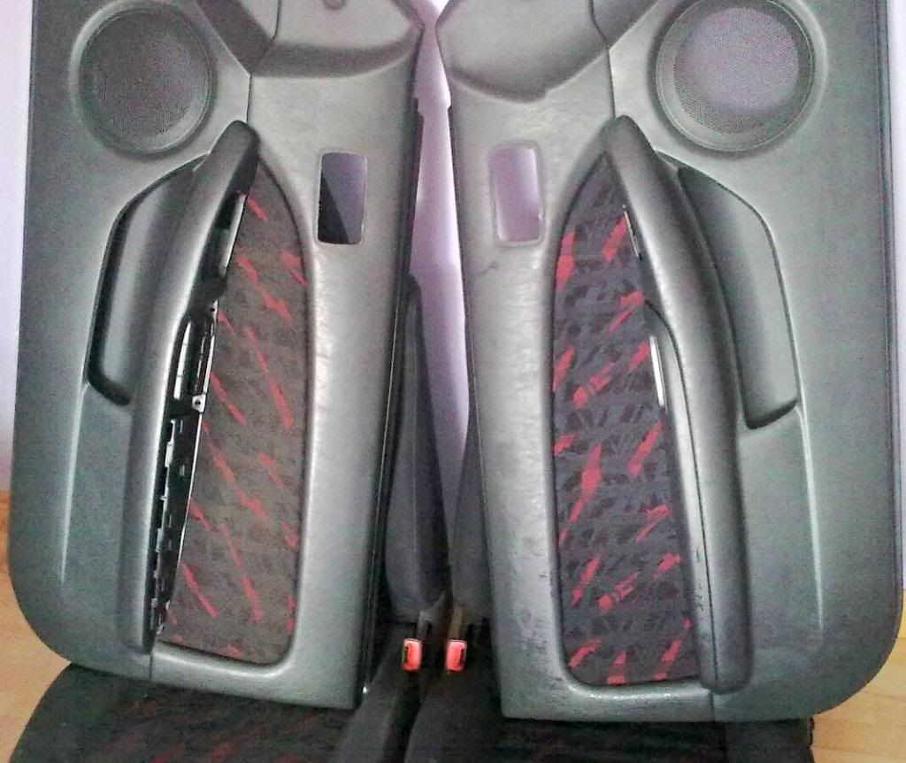

Next I cleaned the door card on the right of the image below is the cleaned door card,
Compared to the uncleaned one on the left.
Below image is both door cards now clean,
Just to prove it does make the difference.

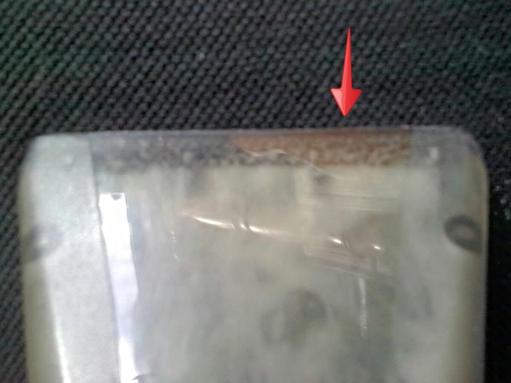

You can see the foam, pulling the dirt from the fabric,
By looking through the clear plastic cleaning head,

Sounds good mate,
I tried the upholstery cleaner on the carpet and it wasn't foamy enough,
So it doesn't work using the upholstery cleaner on other things.
I did need to top up the anti-foam in the collection tank though.
Because the foam was blocking the induction filter at the top left side effecting the vacuum
