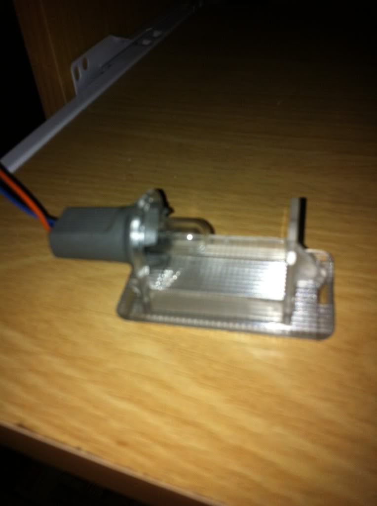

5AA547A2-EDF5-4762-95D9-FBD738EFBDF9-849

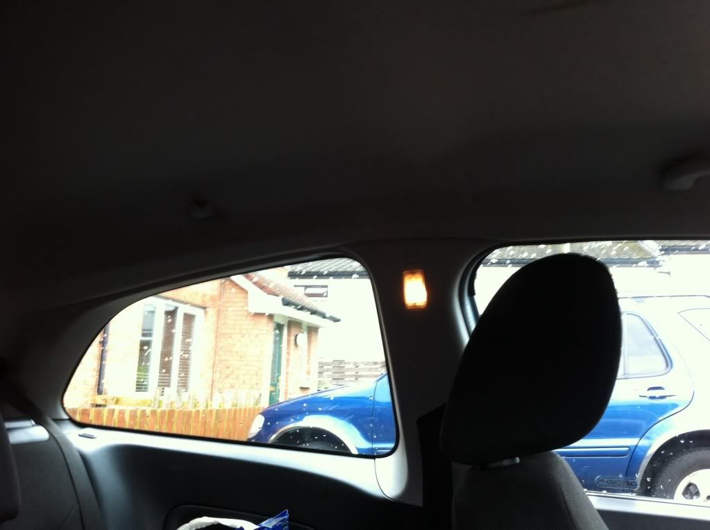

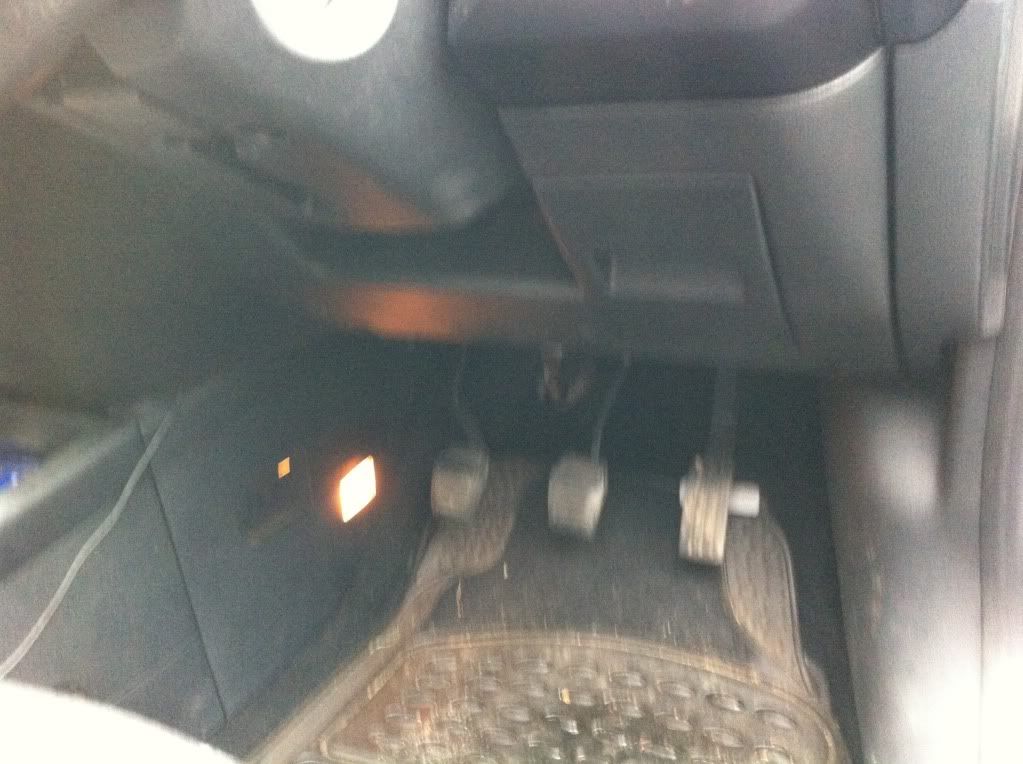

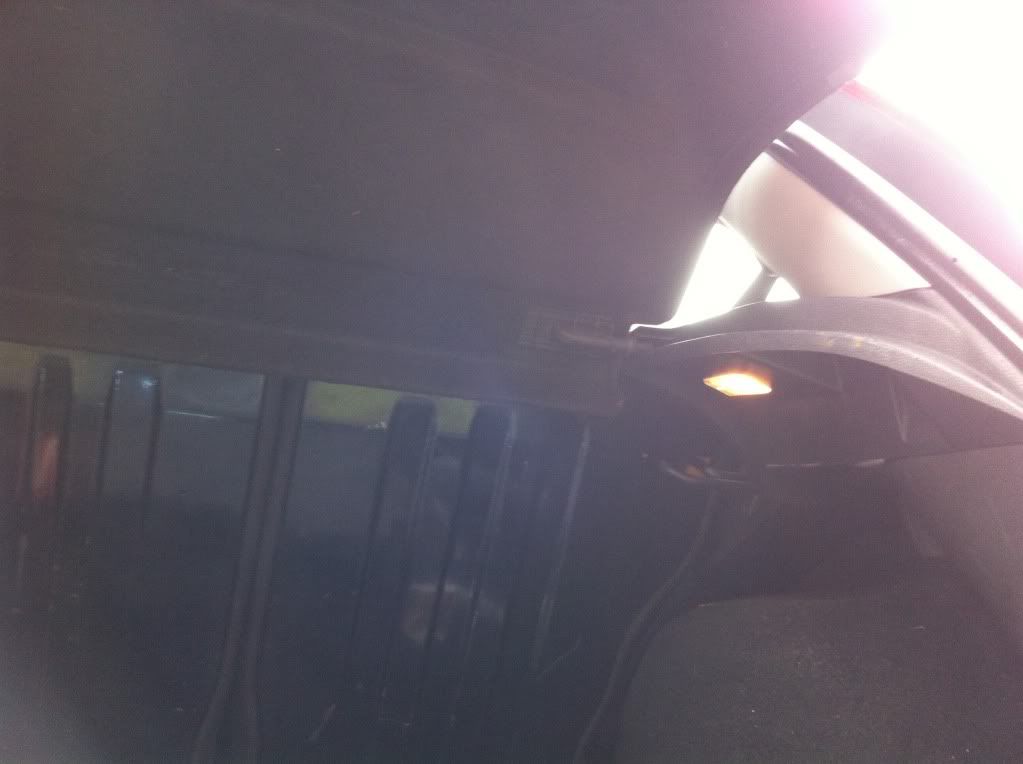

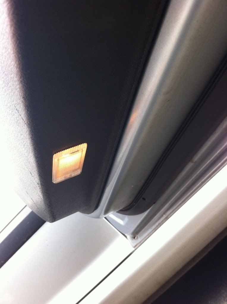

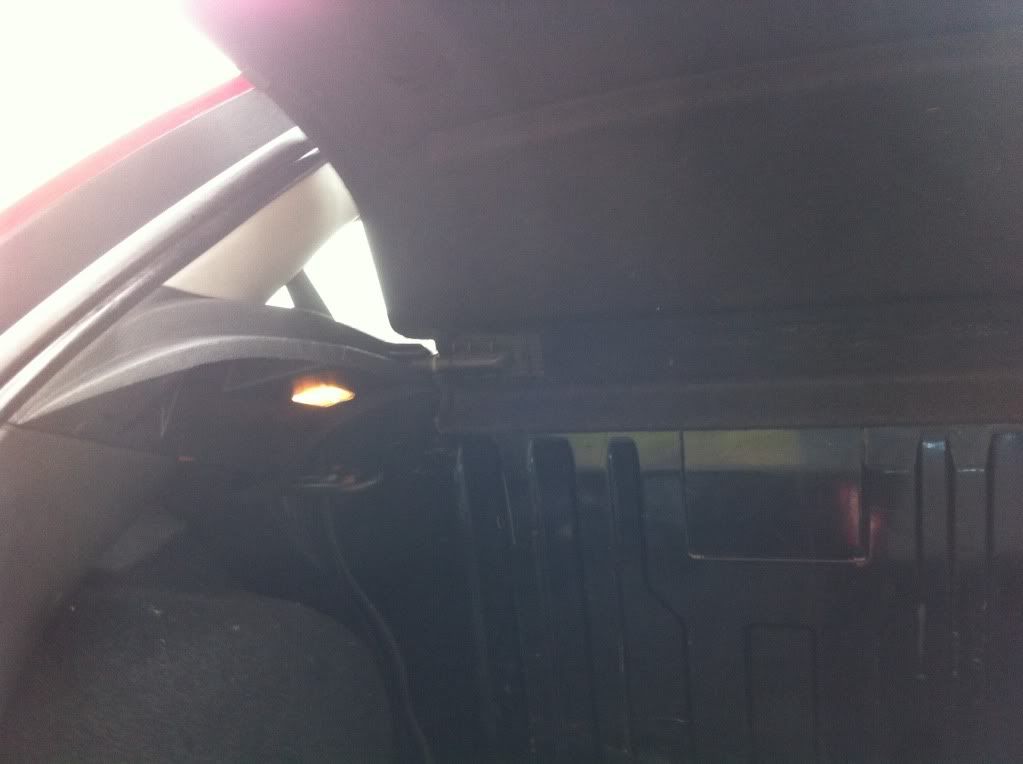

The above light holder is off a mk6 2002-2008 not sure if it will be the same as te mk7? I have loads of them wired into my car lol.... One in each front footwell, one on the underside of both doors, one on each B pillar and an extra one in the boot :-)
Nice one! Aye looks the same!

Ok to wire them I ran a wire from the courtesy light along the headlining and down the (passenger side) A pillar, behind the glovebox into behind the centre consul, wiich is where I wired in both foot well lights, I took a branch off each side ran them along each door scuff trim then up the B pillar. The puddle lights under the door card was a bit trickier, had to remove the door card to secure the wiring then poked it through the multi plug beneath the door hinge then soldered it behind the dashboard.
The boot light was simple.... Just ran a wire from the existing boot light, along the boot trim and up into the opposite side.
They have been in around a year, with no problems whatsoever, there was no need to add a fuse, although it would be simple enough to add one if you thought it necessary. Hope this helps answer your question.
