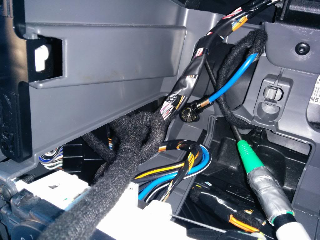

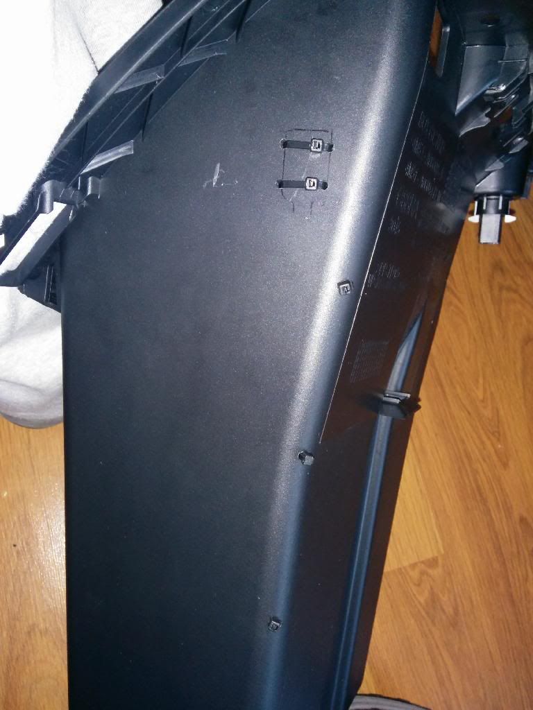

So fitted the retrofit kit today it today main fix took an hour but then decided to get it all nice and tidy so that took me another hour or so. Heres some photos

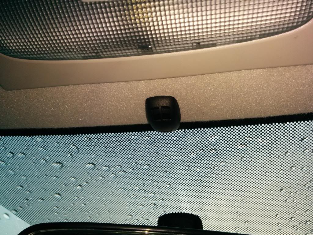

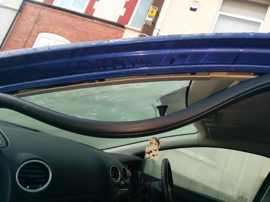

Started with the mic located it centrally in front of the interior light, stuck on with velcro that came in the kit. I was worried it would look out of place but it looks fine, I wrapped the main loom and the mic cable in loom tape last night for a bit of extra protection as I had a spare roll, just pushed it up the front of the rooflining above and down the passenger a puller clipping it into the clips that are already there for the loom to the roof. All you have to do is just remove the door seal- nothing else needs to be taken off (exactly the same procedure as when I fitted the loom I made for foot well lights)
Then removed the glovebox and the stereo surround/ stereo and fitted the retrofit loom - very tight behind there! So I routed the quadlock where the cars loom and retrofit loom meet down into the hole in the bottom left hand corner.
And as you can see the other part of the retrofit loom that goes into the back of the stereo routes back into the stereo cavity. While I was in there I notice a crack in the green connector you can see in the picture that connects the cable to the air direction switch on the heater panel, so wrapped it tightly in gaffer tape to stop it from getting any worse..
From there I routed module connector down into the right hand side of the glovebox cavity and along the front of the cavity
Now looking for a location for the bracket I found what I believe to be a really good place - behind the plastic panel on the right hand side of the glovebox, its the perfect size/fit for the module and I secured it with double sided tape where it contacts that dashboard and then put a piece of thick carpet underlay behind the plastic trim when I refitted it and it is nice and secure with no movement.

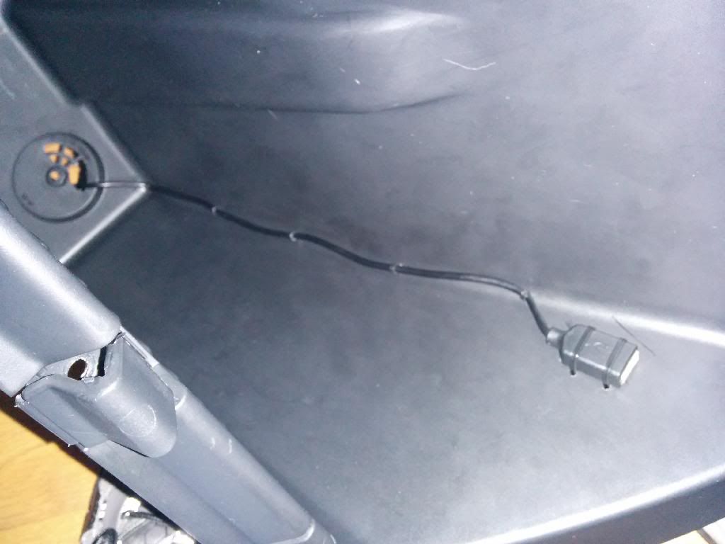

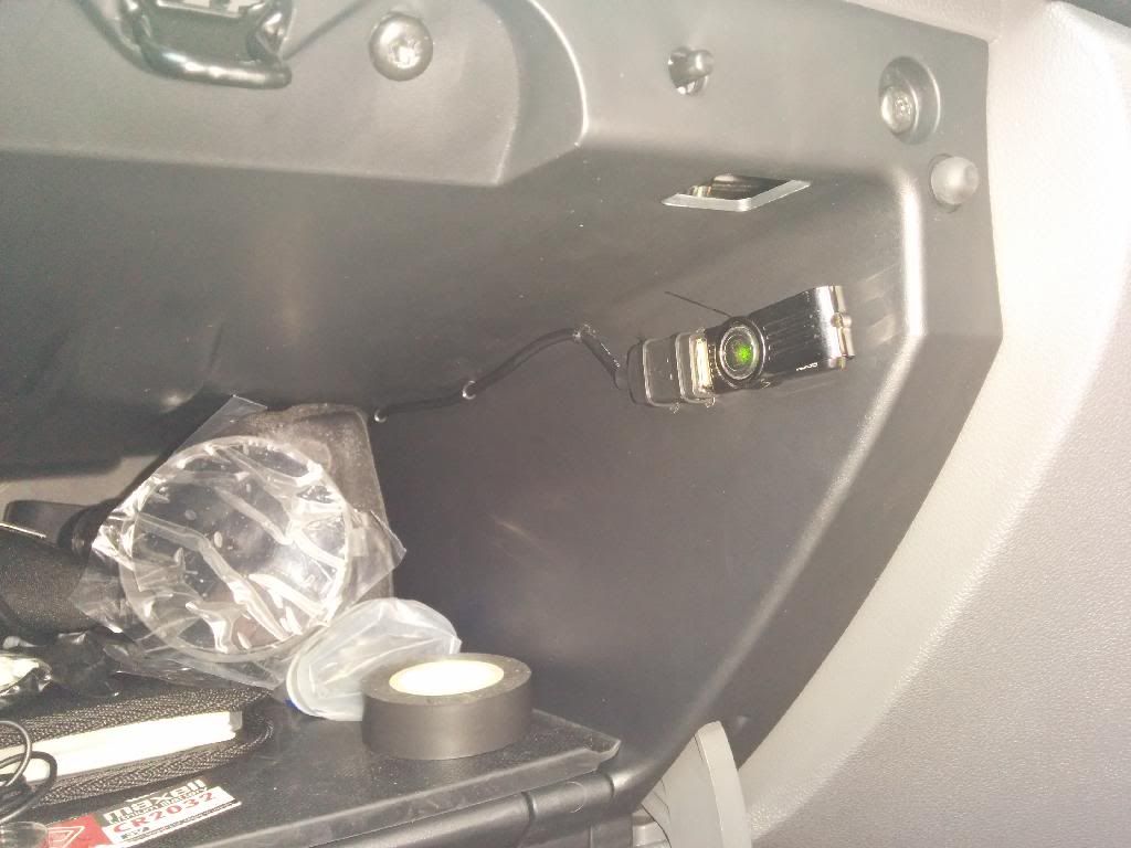

I then decided to neaten up/secure the USB cable in the glove box. I did this by drilling small holes and using small tie wraps to secure the cable, the cable foes out the back of the box where the vent of the cooled glovebox is.
Finished and fitted....
Tried to update the software but it was already up to date.
Picks up my nexus 5 and Mrs moto g fine. A2dp/Bluetooth/USB all work great.
Phone calls are clear both ways. Mode button on the stalk picks up and ends calls. Seek skips tracks but if you want to change folder you have to use the stereo (pitty this can't be done via stalk). Trying to find a way to scroll track/folder names on the display but don't think this is possible. If you flick onto a2dp mode it will even start playing your songs automatically and again you can skip tracks on the stereo/stalk.

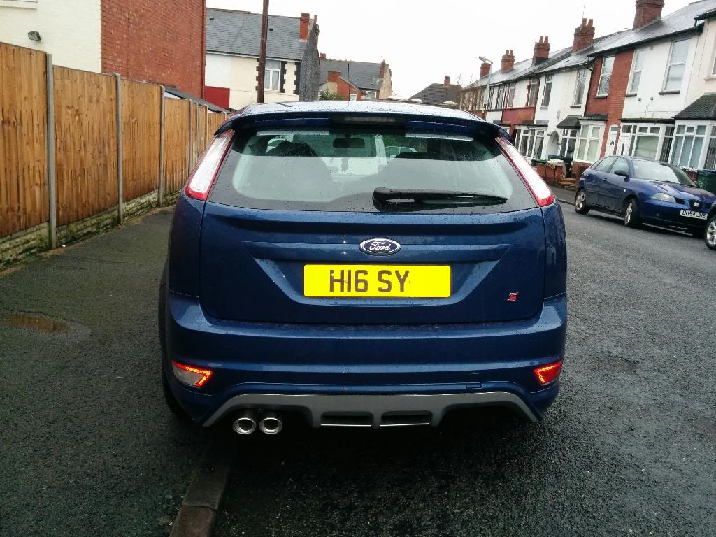

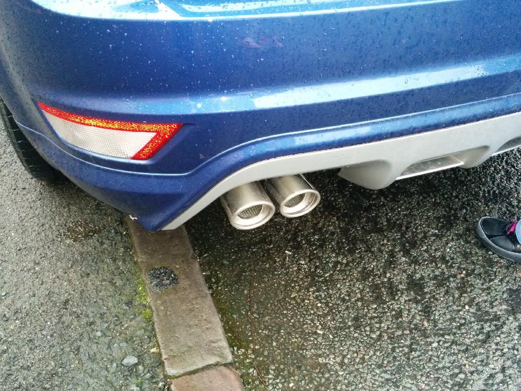

Got the tailpipe done this morning. Went for twin oval as I thought it looked the best. Done at kingswinford tyres (power flow dealer) the dude just cut my existing exhaust just behind the rear axle and then bent up a pipe to fit and welded it all together. Very happy with it. Cost was 65 and it took about 35 mins.

The only thing was I couldn't decide exactly where to place it in the gap as the gap isn't even I wanted it central but that didn't look quite right due to the slopey angled bit.
