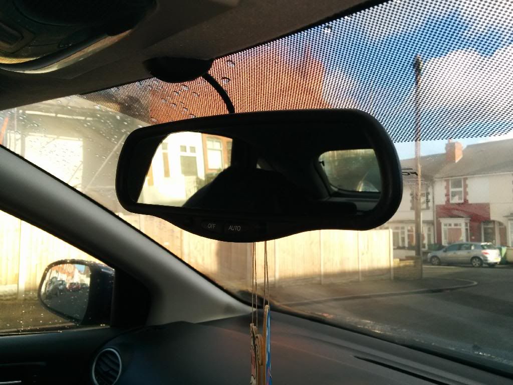

Received and fitted an auto-dimming mirror from a mk3 Mondeo today. Awesome mod for 20 English pounds. Easy enough to fit just 3 wires - one to ground, one to a switched ignition feed and another to the reverse circuit.
I just used the roof ground, ran a 2 core cable down the passenger a pillar then used a piggy back fuse in fuse 108 with a 5 amp fuse for the mirror ( added 2 connectors to the piggy back fuse as I will also be using it for my dashcam when I get it) then tapped d into pin 1 on the big brown connector on the PJB (green and orange cable) for the reverse feed.
So auto dims when ignition is on and when you put it in reverse it switches the dimming off.
Love this mod!

I was lazy and didn't connect the reverse wire. Both wires into interior light :)
Thats the easy way for sure, literally a 5 min job with a couple of scotchlocks.  I just wanted to do it the way it was meant to be lol. doing it that way means it drawing power for 20 mins or whatever the battery saver relay is set too - didn't like the idea of that

dont worry dude I was just sayin. I actually made its own loom with spade connector blocks etc, so the only wire I had to tap was the wire for the reverse  :D

Loving the mirror! Is it the same wiring to a pre face lift?
Is it a case of wiring black wire from the mirror to a earth somewhere then pin 2 from the mirror to the headlight switch and pin 3 is to the reverse. Where is the reverse wire?
i expect its more or less the same but cant say for sure.
Yes its as you say - earth to the roof earthing point then, run a 2 core cable to the the cabin fuse box behind glovebox for ignition live/reverse circuit.
I piggy backed off fuse 108 for ignition live and on the focus mk2.5 the reverse circuit is cable/positon 1 on the big brown connector that goes into the cabin fuse box, green/orange cable.
Very easy to do.

Which is the earth wire on the interior light? Is the single wire?
I think so - I didn't tap the wire I put a proper/separate ring connector on the roof earthing point/bolt.
