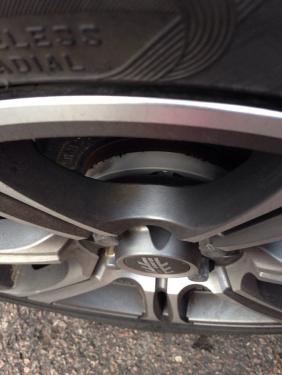

Merv130 Posted April 24, 2014 Author Share Posted April 24, 2014 cheers no wonder mine stick so far out with 15mm spacers mine are et 37 so 10mm more than stock, i have a little problem on my ebiach spacers if you could help, when i put the wheel on coz my alloys have 4x108 and 4x100 fittment the original stud block the wheel from fully engaging but when i tighten them up they fit fine and perfectly but have caused a little damage to my alloys around the 4x100 fittment they have removed some of the metal off the alloy i can take a pic to show what i mean but didnt know fi you had any problems fitting your spacers? also is the shifter just 4 bolts to undo and redo to fit? do you mean the back of the alloy where the bolts of the hub go? mybe a pic would help sorry forgot to say, the shifter is just a mater of stripping down the center console and then 4 nuts and disconnecting the cables and then swapping it all over. I found it easy, just a bit of a pain in the !Removed! Quote Link to comment Share on other sites More sharing options...
D13 HPD 95 Posted April 24, 2014 Share Posted April 24, 2014 Here's what i mean m8 you can see the studs from the axle have damaged the fitment on the alloys which i dont use, is this ok? The alloys are torqued up to the spacer correctly and the spacer is torqued up to the axle hub correctly too You can see its damaged the material Nice one cheers, what cables do you have to undo? I know there aint a lot of room to move about in there carnt be as bad a fitting a strut brace -.- lol Sent from my iPhone using Ford OC mobile app Quote Link to comment Share on other sites More sharing options...
Merv130 Posted April 24, 2014 Author Share Posted April 24, 2014 is there a gap between the spacer face and the alloy in this photo? I would be more concerned about that than the damage, did you ever consider getting the spacers with longer bolts? might solve the issue for you. the cables that select the gears, they are on a ball joint connection. they pop straight off and pop on same area in mountune one. Quote Link to comment Share on other sites More sharing options...
D13 HPD 95 Posted April 24, 2014 Share Posted April 24, 2014 is there a gap between the spacer face and the alloy in this photo? I would be more concerned about that than the damage, did you ever consider getting the spacers with longer bolts? might solve the issue for you. the cables that select the gears, they are on a ball joint connection. they pop straight off and pop on same area in mountune one. no there isn't my alloys have a weird fitting to the spacer and did on the axle it comes down at an angle then it sits flush with the spacer, i know the ones you mean but i haven't a clue on how to fit them at all :/ and spent quite a bit on these lol and cheers for the info might have to order myself one soon :) Quote Link to comment Share on other sites More sharing options...
Merv130 Posted April 24, 2014 Author Share Posted April 24, 2014 If its sitting flush then I wouldn't be as concerned about it, its not like you need the other fitment, I would just keep an eye on it. replaced my aerial today, my old one had weather badly and the end had somehow went missing. new aerial fitted Quote Link to comment Share on other sites More sharing options...
D13 HPD 95 Posted April 25, 2014 Share Posted April 25, 2014 Yh i wipped the wheel of this morn and you can see where its been sat flush against the spacer so thats fun there wasnt any wobble just concerned lol but na all good, thx for the help, and is that a bee sting? Would you mind doing a review on how the reception is on one of them? Ive heard a lot of mixed opinions Sent from my iPhone using Ford OC mobile app Quote Link to comment Share on other sites More sharing options...
