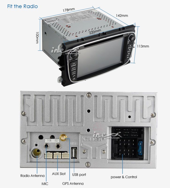

They are primarily designed to function with the 7" Android based touch screen stereos that are also available from China,
I've heard two stories on Focusownersclub.com back in 2012 regarding them catching fire however no images to back up these claims leading me to believe such claims are purely speculation although buying from China there are no guarantees buyers risk.
The Ford supplied Sony Stereo doesn't have a 3.5mm Phono socket or a Micro USB socket at the rear,
However the Blaupunkt satnav model may have these interfaces at the rear but I'm not very confident that it would to be honest.
Overall its main design was to work with one of these:
http://m.ebay.co.uk/itm/270955913399?nav=SEARCH
http://m.ebay.co.uk/itm/181411735218?nav=SEARCH
