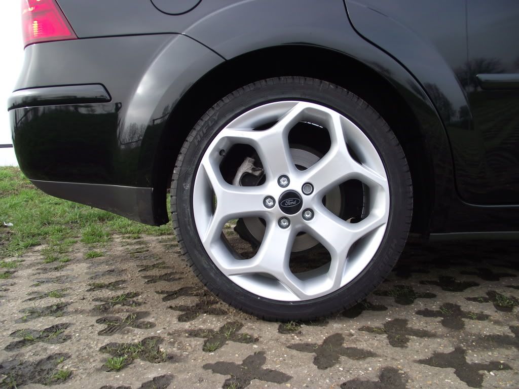

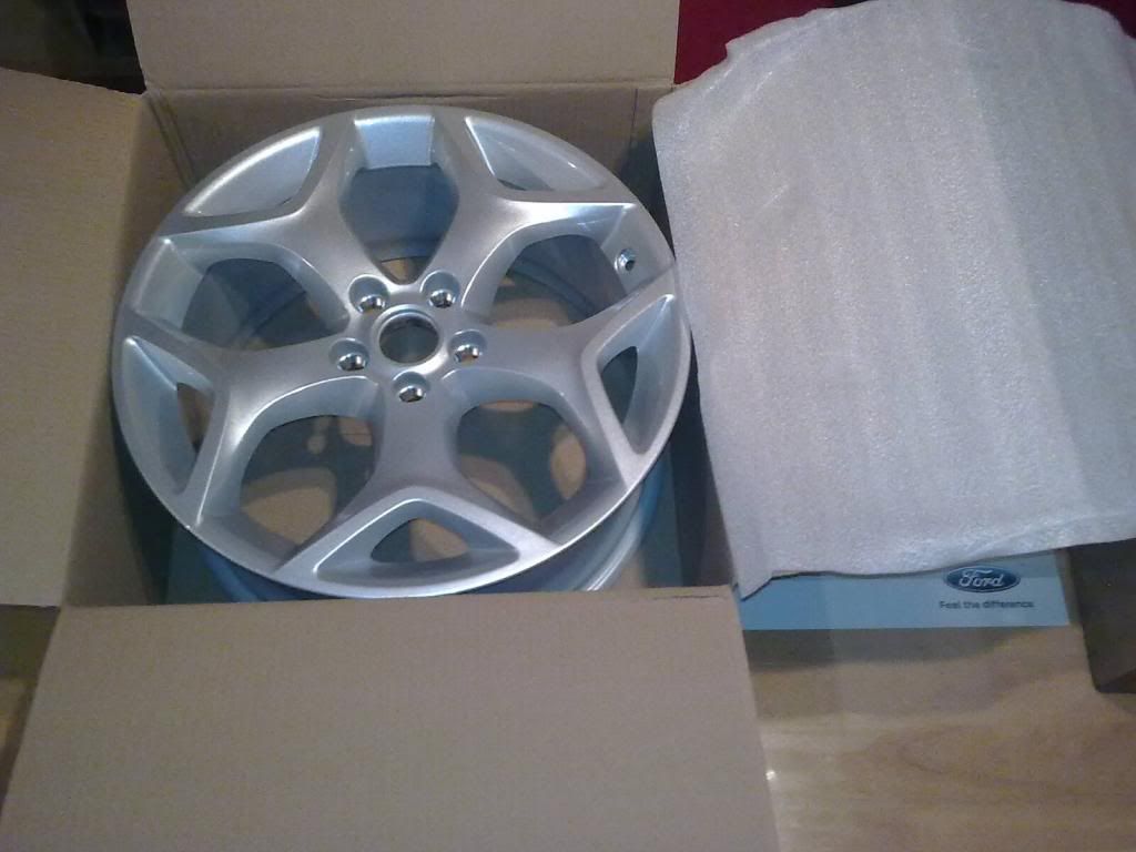

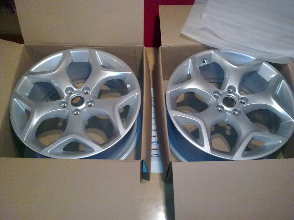

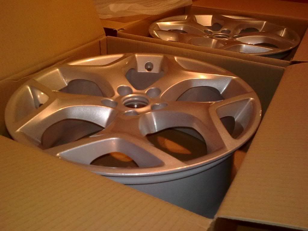

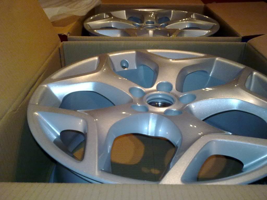

Genuine facelift ST alloys have a centre spine on the spokes,
They dont need spigot rings to fit the car,
Ford supply them so your guranteed safety checks have been met,
They will be 18x8" and 200 a piece is 75 pounds cheaper than i got mine from ford, Manufactured in Germany
Tyres and centre cap seperate.
Heres some pictures of genuine facelift ST alloys
