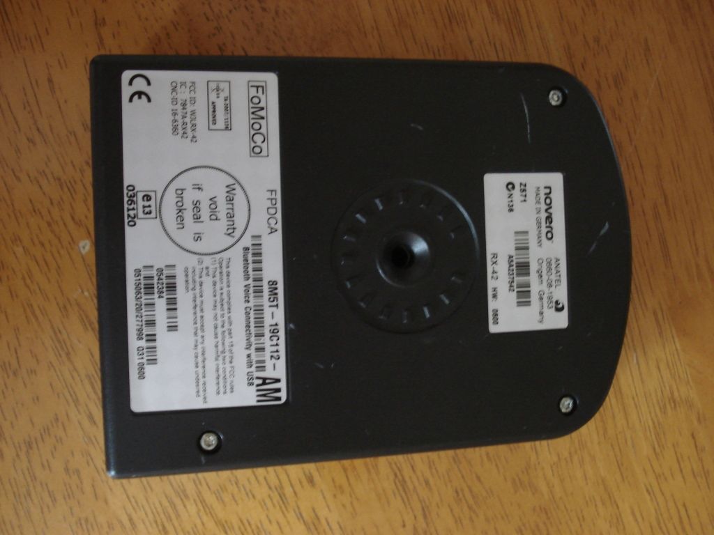

Ok, I've finally managed to snag a USB module off ebay for a reasonable price. I think I may actually have bought it from iNath actually...
So, it's a 8M5T-19C112-AM. I just need to get the cable, USB port and fascia from somewhere. Any suggestions?

what is the difference between 8M5T-19C112-AN, 8M5T-19C112-AR, 8M5T-19C112-AM ?
If I got the AR or AM versions would ie be a problem?
Cheers
Mark
Just the production dates, higher letter = newer.

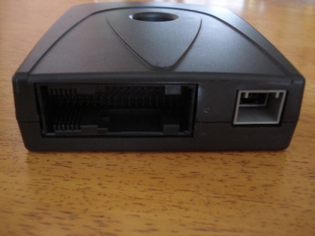

It's important to check the type of connection on the module (mini USB is preferred)

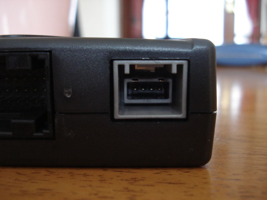

Apparently, anything up to the AM model uses an older, proprietory connector. Anything after, (AN, AR etc) uses a mini usb.
Shame I found this out after ordering a mini USB cable off ebay when I've got an AM model... Ah well, live and learn.
But just to confuse you SOME AM modules have mini USB ;)
Seriously? I think Ford is trolling us.
My AM has the one that looks like a regular USB port but is too small.
