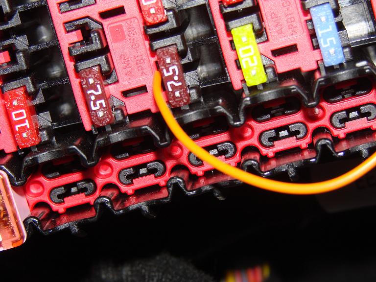

Yep, I encountered this problem as well. As you say, the GEM is not there! I will take a picture tonight of what I did with the wire as I wasted a lot of time to find the apparently non-existent module.
Here you go mate its not ideal but definetely the easiest solution. I connected the wire into the headlight levelling circuit (via the fuse). It will tell you in the manual which fuse this is as it varies depending on the fiesta model. It means that the gear knob is on all the time but thats no bad thing ;)
IIRC the earthing point which Ford recommends requires you to remove the door sills and carpet. There is another earthing point in the glove box area which requires none of this hassle.
Hope this helps
Mate, you do not know how helpful that is. I've spend the last few days either looking for it or waiting on the phone with useless Ford dealers who have no clue about anything. I cannot thank you enough, legend ;)
