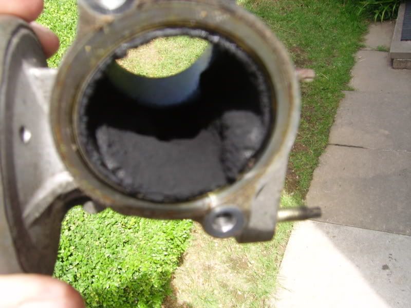

Ok the RAC have been out and the egr valve is clogged up he tried to clean it but it didnt work so
can you clean them and if so how

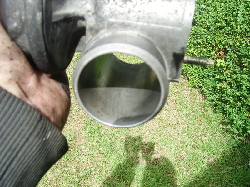

egr can be cleaned with gunk, or carb cleaner, its a very messy job. ;)
I can agree with Eggsy, I cleaned mine out just before the cold set in, cleaned the black intake manifold too and made loads of difference. Messy, but a reasonably quick and easy job to do.
