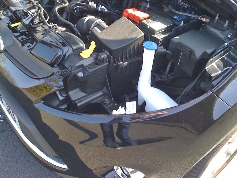

The light units need to be taken out to fit the new bulbs. I took mine out when i fitted my LED sidelights, it doesnt taken that long and isnt that hard, just need to follow the hand book on how to do it :)
The white clips you can see in the picture is what holds the light unit in place, they need a little force to pull out other than that its just 3 or 4 screws i think!
Bascally that white clip shown above is the only problem cause you have to pull quite hard but don't be afraid as long as you've followed the book it will pop off :)
Took me about half hour to do all my front lights, bout 20min of this was working out how to get light off in the first place

I snapped one of the white clips the other day aswell, I've changed bulbs on the car before and had no problem, but the clip just snapped the other day. May have had something to do with the cold though, it was well below freezing when I did it.
The light doesn't feel any less secure but does anybody know where I can get a replacement clip on the Internet?

Would appreciate some pictures to look at. Is there any special tools I need also is there a yellow type screw plug of some sort to release as well but do's look difficult even now after the other guy tried and snapped his white clip. Many thanks
Thought i would put the pic i took when i was half way thru show the difference :)
I broke the clip too when I was changing my bulbs, you can get one at your Ford dealer, my was maybe for 5€?

i have tried taking the headlight unit out but something seems to be stopping it coming out, is it any thing to do with this white clip, and where is it
My vision blues are ok and don't have a yellow tinge, be careful as some bulbs can be too bright for road use.
so you would give them the thumbs up? I just want a nice White/ bluely light instead of the standard orange!
the White clip is what I would think is holding it down. Make sure u have all the screws out and give it a little more force. Worse that can happen is you have to buy another clip :)
took 3 screws out and elec plug but i think if i force it i might break something, but if its all you do then will try to be abit more forcefull, many thanks
