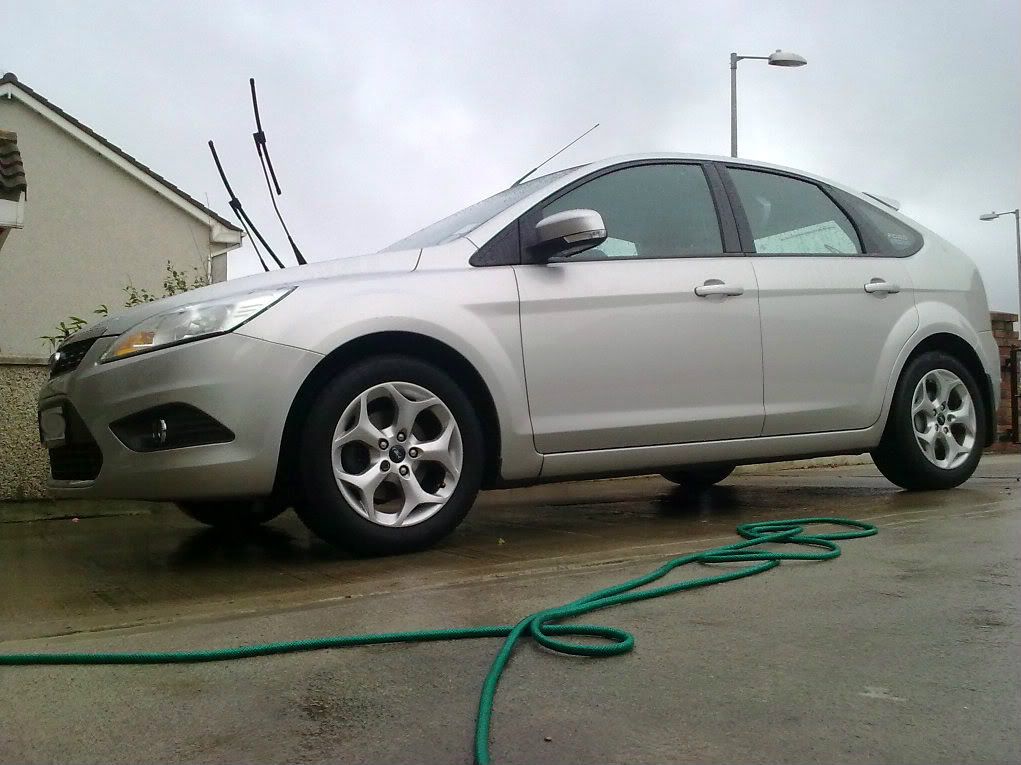

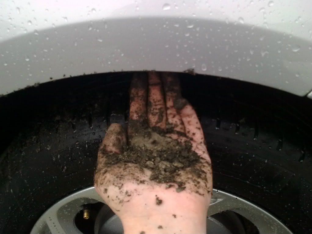

    preferably on a warm dry day using a high pressure hose wash the car thoroughly,
    also using your hands reach under the tops of the arches and although the car may seem to be spotless,
    its amazing how much solid muck gathers under there,
    as you can see in the picture below I gathered at least five handfuls from each rear arch even after power hosing.

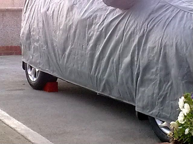

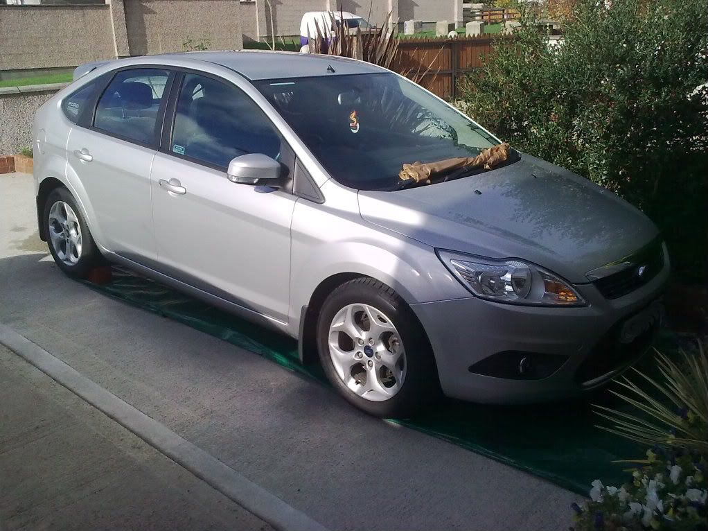

    Lay the Tarpaulin Ground sheet in the area where you plan to store the car and park the car on top of it, the purpose of the ground sheet is to prevent damp from seeping up under the car and becoming trapped in the body due to the cover on top of the car.
    Next

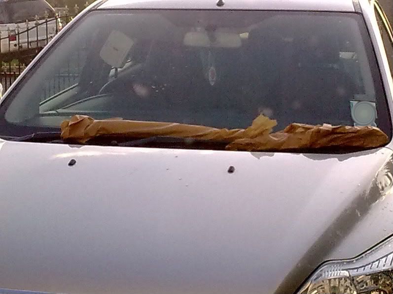

    using some grease proof paper wrap the wiper blades, to prevent them from sticking to the glass, i purchased tesco branded grease proof paper for this, i think it cost around £1.48

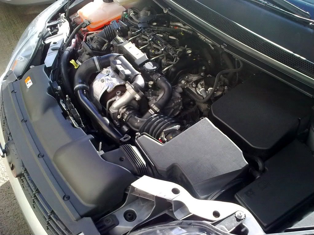

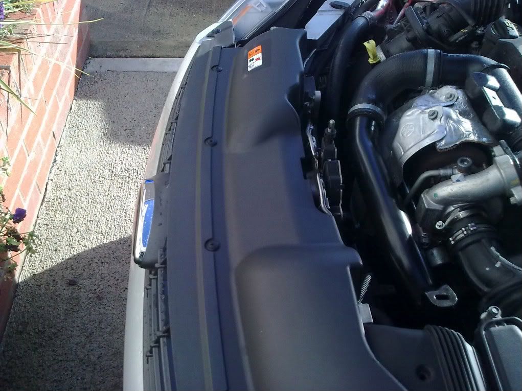

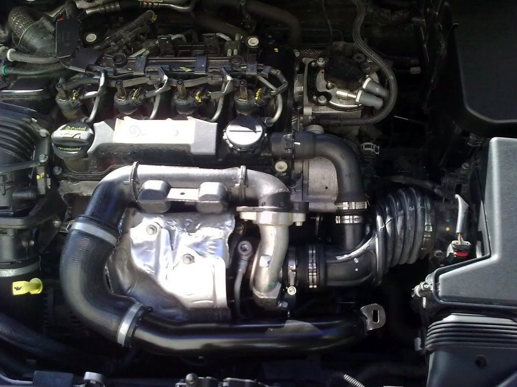

    Once the engine has cooled, get a dry cloth and the can of WD-40 spray the cloth with the WD-40 and wipe down all accessible areas of the engine bay, all plastics rubber and tanks, see pictures below.

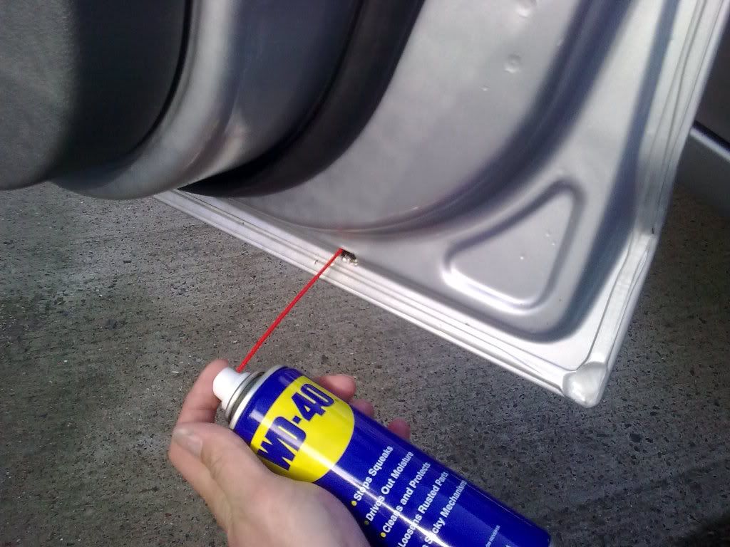

    Using the WD-40 also spray a short burst in to the drain holes in the doors and either side at the bottom of the front windscreen see picture below:

    place the chocks in front of the wheels disengage the hand brake and allow the wheels to roll tight to the chocks, ensure they are aligned up correctly and leave the hand brake OFF in the car.
    as if the handbrake is left on the rear drums will stick to the axle causing a nightmare when it comes time to get the car rolling again ohmy.gif

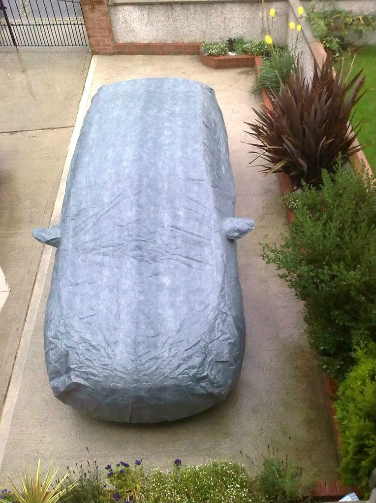

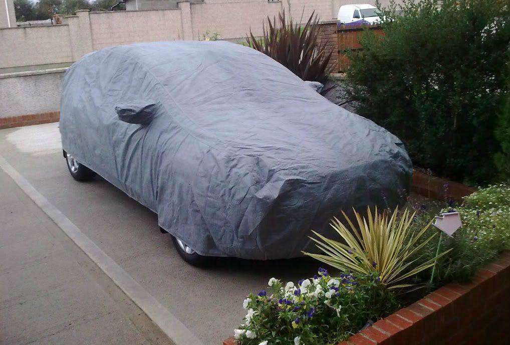

    Remove the cover from its storage bag, and fold it out,
    One person on the front wink.gif and one on the rear next to the car dry.gif , spread the corners out and place over the car,
    Gently slide the cover down the body and fasten the two straps under the body, followed by the metal rope and pad lock.

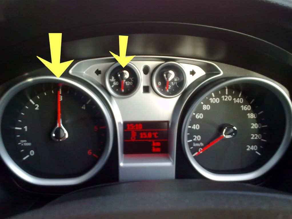

    Allow the engine coolant to reach normal operating temperature,
    Then press the accelerator and hold it at 3,000RPM on the gauge for up to 10 minutes (Diesel Models)
    This simulates taking the car for a run on the road, clears the exhaust of moisture and gets everything flowing as it should,
    While you’re in the car switch on the air-conditioning and turn it to full heat for 5minutes and then to full cold for another 5 minutes switching to different air flow directions periodically.
