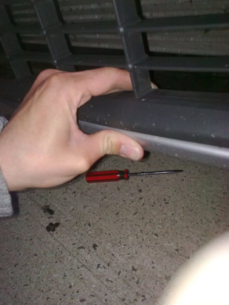

Lie down in front of the grill place the palm of your hand on the lower Painted part of the bumper and the other hand as shown below,
Gently pull the panel from the bumper and work your way around anti-clockwise
inch by inch gently pulling straight not at an Angle,

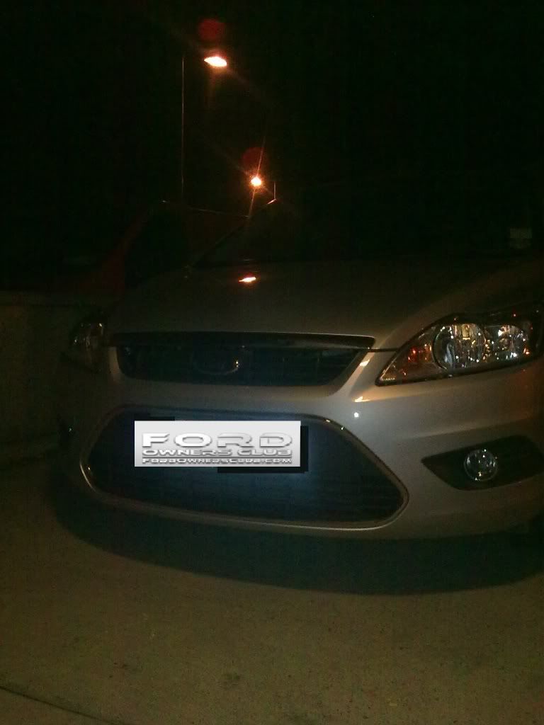

Ready for the new grill to be mounted you should eventually look like this Picture Below.
My choice of Replacement Grill was the Titanium grill with the chrome lip,

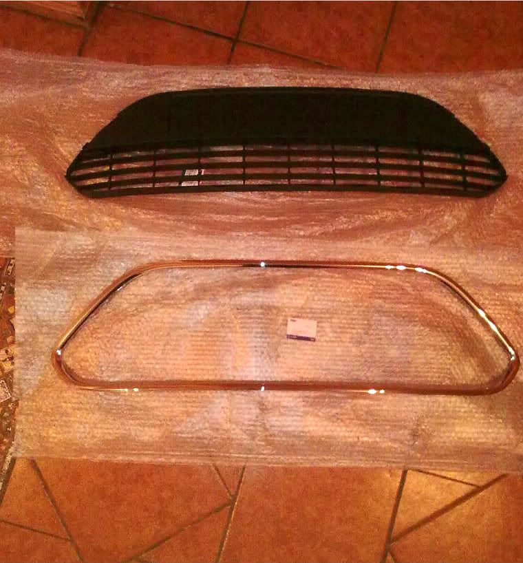

The chrome and the grill are two separate parts which should be clipped together prior to mounting, it is also advised to mount the number plate while the grill is off the car,
To attach the chrom piece to the grill prior to fitting on the car
Gently press the chrome lip on to the grill again inch by inch working you way around the panel,
