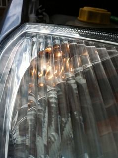

From this(old image)

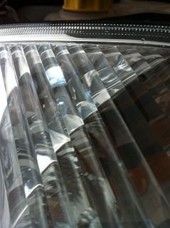

to this(new image)

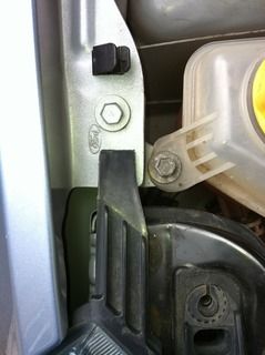

Ok first of all open bonnet and remove the two screws on the top of the headlight using either a flat headed screwdriver or a T30 torx.

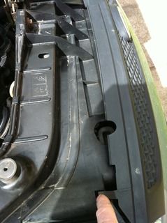

then remove front grille by unclipping both ends(and a clip in the middle) and lifting from the bottom being careful not to break any of the clips.

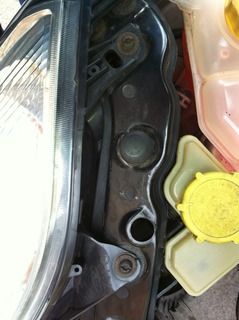

Once the grille is off, this will give you access to the last screw......

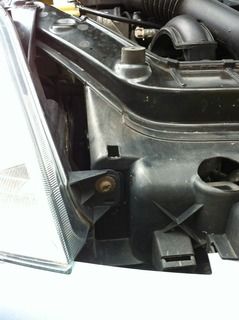

Once removed there is only a couple of clips holding the unit in..... one on the top, insert flat head screwdriver and twist(careful not to scratch paintwork)

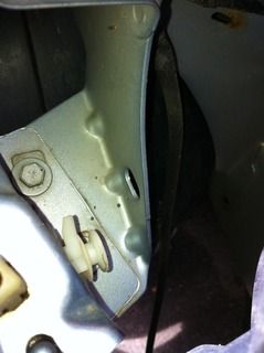

Once unclipped.... the last remaining clip is under the light unit attatched to the wing, to unclip this firmly hold the light unit from the botton and lift upwards.

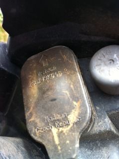

The whole unit has now been removed, now all you have to do is remove the rubber weather shield from side light housing...

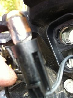

then carefully pull out the old light from the housing and unclip from the holder.....

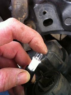

now to fit the LED's just gently push into the housing (checking that they are the correct way around as they will only work one way).......
