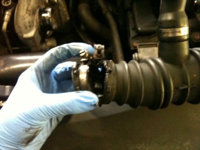

I also examined all the rubber and plastic hoses and connections on the turbo system and found a few things. The rubber hose that goes from the air cleaner box into the turbo is cracked at both ends, the end that connects to the tube being sliced almost clean off

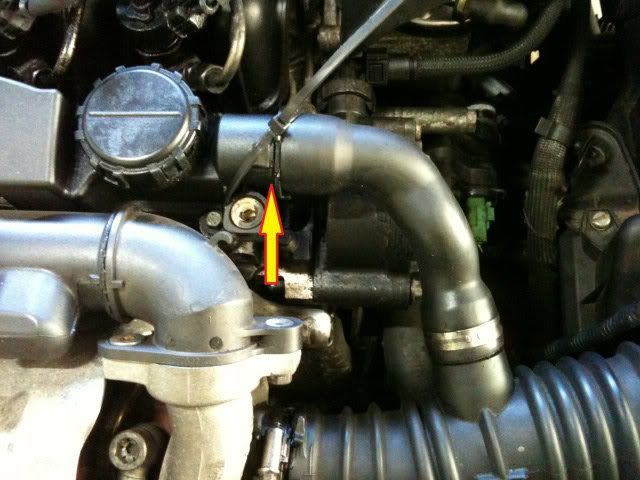

Also the pipe which tees off this and connects to the engine to the right of the oil filler cap below the injectors (yellow arrow in pic below) looks like it has a couple of clips broken off it. It's being held loosely in place by a zip tie...

So would these two areas account for my turbo leak whooshing sounds like the blowers are on in the cabin type noises?
Are these pipes expensive to replace?
Also, all the pipes I inspected in the turbo system had a lot of oil in them. The areas of engine adjacent to the points where the pipes shown above were split were also covered in oil. Is it normal for there to be oil in this pipework? Doesn't seem right to me.
