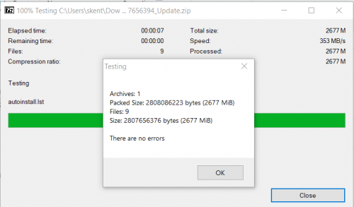

scoggy Posted January 21, 2020 Share Posted January 21, 2020 That response from Ford is very similar (or the same) to the one they've been sending since early last year (see the link below). https://www.fordownersclub.com/search/?q="and our Technical team are working to resolve" Given the uncorrupted files CAN be retrieved from the Ford servers by some people and using some methods (see my posts on this and other threads) it'd be great if we could find a consistent way to get them. I'd wondered if there's a collection of the files anywhere. Searching on Google I found a post on a Russian forum which has various versions of the files available: https://ffclub.ru/post/18683966/ I can't vouch for this, but there are enough postings about this Russian forum on this site and across other similar sites and people seem to use it. 1 Quote Link to comment Share on other sites More sharing options...

erictcleric Posted January 22, 2020 Share Posted January 22, 2020 Tip of the hat to scoggy there - I had the same update issue with the corrupt files. What fixed it for me was using the direct URL to download the update rather than clicking the button on the Ford update site to download. That allowed for extraction of the files without any CRC errors. This is something I've seen before with other cloud-hosted downloads; sometimes a fancy button to download the files results in slow or corrupt data, whereas using the direct download URL seems to work. Interestingly, the update link I got for my 2017 Mondeo points to the same download file scoggy used, so I suspect it's tailored more to the Sync version rather than a specific vehicle. Quote Link to comment Share on other sites More sharing options...
