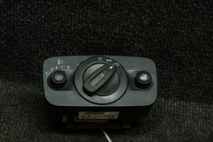

Now on the dash board where the lights control panel is, the rear fog light button is marked as such, but the button for the forward light has no such marking (I assume as there's no lights),
(not my picture by the way, just using it as an example of one that matches my control) but as this button presses in, will I be able to actually use that to turn on the light bar or will I have to replace the control panel with one that's designed to have front fog light operating capability?
The lights run through the BCM so it’s not a simple job. Check where the fog lights should fit. If the wiring is there then you just need a functional switch and enabling fog lights through Forscan. You could then wire the fog light loom to your light at using a relay.
As an aside you could do this with a set of OEM fog lights from a wreckers for under £100.
£5000???  you got to be kidding. as just said get the switch and oem fogs from a scrapyard and plug them in, bet the harness is there if you look.
