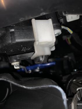

Docker Posted November 1, 2018 Author Share Posted November 1, 2018 Hi Ivan Glad you like the guide mate If you lie in the right hand footwell drivers side and look up beside the leg airbag and centre console you can see the arm working mate I've added 2 pics to show you. You can also get a finger on it (don't trap it though lol) One is actuator in place the other removed. When looking up you can see if it operates with everything attached. The actuator is only screwed on with 2 torx screws I will say one is a pig to get to I ended up using a 1/4 inch torx bit and a 1/4 spanner undoing bit at a time If the arm is broken my words of advice is get a 3d printer to make one up as I've quoted in above Orijas website is www.orijadesigns.co.uk. They maybe able to build you one like mine at a fraction of the cost of buying the set from Ford if it's not this then go to left hand side passenger footwell there are 2 pipes these should be very hot if they aren't then youve possibly got a heating problem within the cooling system hope this helps Quote Link to comment Share on other sites More sharing options...

johnnyfive Posted October 22, 2019 Share Posted October 22, 2019 I have 2009 titanium with the auto climate control. My problem is buttons won't move the vent flaps. I lowered the glove box, pulled off the plastic air vent directing to passenger footwell to expose the actuator controlling the vents. The actuator motor is working. But there is a black plastic arm (highlighted in purple) connecting the actuator motor to a metal rod. My plastic arm has part broken and won't move the metal rod. The metal rod moves up and down and is what changes the the 5 or 6 possible flap directions. You can move it manually here if you wish.This plastic part clearly seems to be one of the ten parts from the "Genuine Ford Fiesta MK7 MK8 Heater Air Distribution Lever Kit 2008- 1827184" costing £139 on eBay. I just searched eBay with "1827184 ford part" and folk are selling aftermarket versions of my single broken part for a lot less. It's clearly a recognised bad design fault. Quote Link to comment Share on other sites More sharing options...
Youget246 Posted November 17, 2019 Share Posted November 17, 2019 Thank you so much johnnyFive, I got the airflow of my ford fiesta stuck on face position, so I started to look for that actuator and that metal rod on passenger side but I only found the actuator that open and close recirculation flap. I'm from Belgium and I remembered that you guys are mostly posting from UK having driving position on the right hahaha. So I just laid down on driver side didn't remove anything and I saw the actuator trying to turn but like the post above the plastic piece is broken. I moved manually the system to have airflow on the windscreen until I get a new one and replace it. 😃 Quote Link to comment Share on other sites More sharing options...
