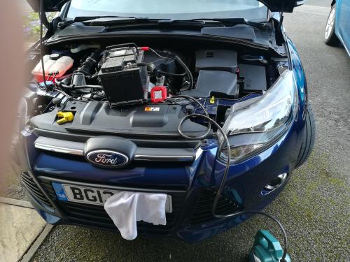

Neb_engineer Posted March 10, 2019 Share Posted March 10, 2019 A few months ago I was trying to do an oil change on my fiesta because I found out that it hadn't had one since 2014 despite being survived by ford in may of 2018, I then found the sump drain plug was seized and I rounded it off trying to remove it, then this morning I attempted to try again and noticed that the sump must have been off at some point because ford didn't replace the gasket with a new one instead they used bathroom silicone sealant instead. The more I look under the car the more I see bodged work from ford. Quote Link to comment Share on other sites More sharing options...

Neb_engineer Posted March 10, 2019 Author Share Posted March 10, 2019 6 hours ago, stef123 said: If it was serviced in May 2018, what proof do you have that the oil was not changed? i know the oil hasn't been changed since 2014 because the last record of am oil change is from 2014 after that there are no more records of an oil change after that, but there are records of other things that the dealer changed at the annual service, also 2014 was the last time that my grandparents (the owners of the car) drove the car until september 2018 when i got the car. The milage of the car when i got it was 5794 miles and it is now 10044 miles. The sump did also have a paper gasket (although not shown in the picture) and i could see that it had been ripped and that ford used some kind of sealant (that looks like bathroom sealant) to reseal the sump instead of replacing the gasket. And the fact that there was a paper gasket there to begin with wasn't inspiring confidence. Quote Link to comment Share on other sites More sharing options...
