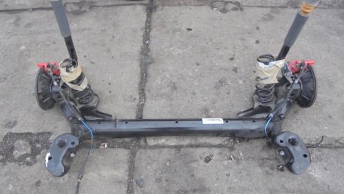

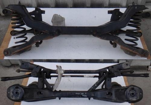

You're looking for something like the following examples. These are general examples but should make sense once you compare what you have on the car.
The MK7 fiesta torsion bar setup looks like this:
Notice the long single tube across the car. The idea is that tube/beam twists under use giving some measure of independent movement but without the expense of a proper independent suspension setup
This is the MK3 Focus independent rear suspension:
Notice how each side of the rear suspension has a top and bottom arm and its own pivot point. On this setup each wheel can move independently of the other (anti-roll bar aside).
If you're still stuck try taking a photo from underneath the car and we'll have a go
Thanks for all the interesting replies guys.
Just had a look under the car, and yes as you can hopefully confirm from the photos it looks like I have indeed got the independent suspension set up.
Looks to me similar to the MK3 set up with independent pivot points either side of the exhaust pipe.
That looks like an independent setup to me.
