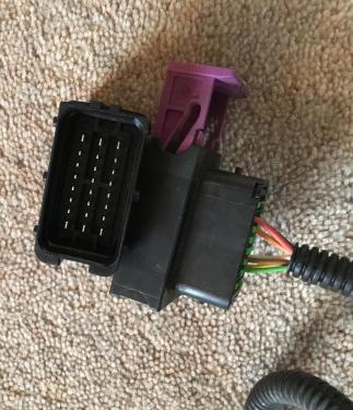

Over the last few weeks, my car has been hunting at idle, until it’s up to operating temperature and then it seems fine. Poking around under the bonnet with the engine running, I fiddled with the wiring looms and the hunting stopped. Looking at the wiring, I decided it didn’t look genuine, so investigated further and found sensors plugged into this non genuine looking loom and then a black box dangling down the back of the engine. So I’m guessing this is a tuning chip box thingy the previous owner fitted. Must be a cheap eBay special as it’s got nothing written on it.

The pics to me at the moment  are low res due to bad internet signal.. but it almost looks like someone's shifted the OBD port? Are there any markings to go by?
Apologies, it could be anything but from what I currently see! Lol
Sorry, those pics were a bit dark, I was trying to juggle an iPad in one hand and a torch in the other, which was very difficult considering one of my hands was in the picture.🤣
Possibly obvious from the first picture, one of the units plugs goes to this sensor here, which I’m guessing is the MAP/boost pressure sensor and the other one disappears down towards the gearbox, where I believe the fuel rail pressure sensor is.

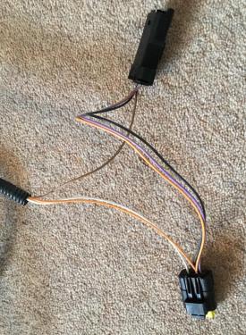

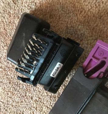

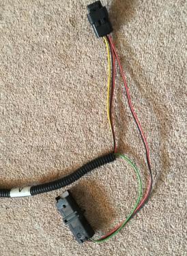

Took the box off, as predicted it’s a cheap eBay special, does literally nothing to the car, except the bad connection causing my hunting problem. The wires going to the “tuning box” are just bridged inside it. The red and black wire going from the MAP sensor just end at pins. All looks very impressive with that mass of pins, but most of them aren’t connected to anything.

Been doing a bit more research and it turns out this wasn’t quiet as bad as it looked. Turns out it’s part of a Racechip tuning box which I think is a fairly well established company. The box fitted to mine is designed to return the car to stock without having to remove all the wiring when the car is sold. The proper tuning box can then be returned to racechip to be reprogrammed for your next car.
