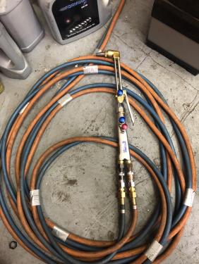

Next time just remember, it ain’t seized if it’s liquid 😂

Defo m8  and all is well now I soo need one of those would be sorted in no time lol
