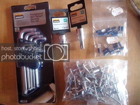

And you will need a Philips head screwdriver, flat head screwdriver, a T25 torx and a TX40 torx available to purchase in single form from halfords as saw below;
I can guide through the process if required, get price from garage if there charging more than 50 pounds to fix then DIY and I'll piece together the images.
Goes somthing like this guide I made earlier:
