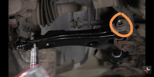

I've just had the lower ball joint and wishbone replaced as in the photo after suffering with a loud clunking/knocking coming from the left front for some time. Strangely, it made no noise at speeds over roughly 35 mph. There was also no noise under acceleration or braking, but it was awful at slower speeds on poor roads. It's all sorted now thankfully. Cost me 60 quid for parts and labour.
I should add, sorry, that the price was from a mechanic friend of mine. The parts are almost 40 quid. I don't mind paying that sort of money for him to do the work. How much in a regular garage, I don't know.
