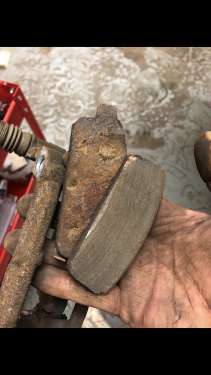

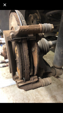

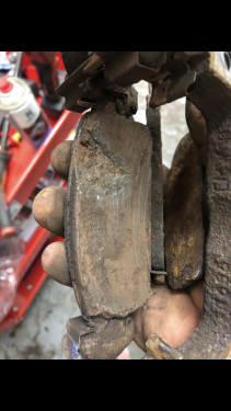

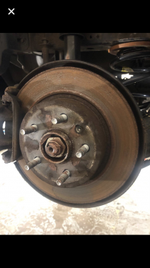

A little off topic so my apologies now😬
I've just had 3 year old Mokka X in with ‘handbrake issues’. Drove it myself and sure enough, something not right.
first step in the process is to strip both rear brakes and inspect. Both side the pads were absolutely solid in the carriers! One pad on each wheel the lining come apart itself and one pad on the drivers side had a massive chunk missing like someone had battered it with a screwdriver before. This car had only just been in at the dealer to have this problem looked at! When asked what the problem was they were simply told, it just needed adjusted!! Btw it’s fixed now.
  • Haha 1
  • Sad 1
Link to comment
