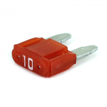

Great, can I ask what amp fuse did you use for your dashcam?
10 Amp mini blade
