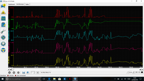

Hi @Tdci-Peter & @TomsFocus,
Many thanks for your help so far trying to sort out my DPF issue (especially thanks to @Tdci-Peter for your brilliant FORScan instructions).
I've just got back from my test drive and have attached the log file & test drive results - screen shot & data (I've altered the extension to .txt).725546668_Screenshot(1).thumb.png.b73cf7e5ce3c533f23159e106e598e49.png1257657119_Screenshot(2).thumb.png.5b521660812eea27a18b90072f067721.png
I had a few more faults than I was expecting: P1632-20, P0134-23, P2463-A0, P253F-60, P0490-20 Should I be concerned about any of these?
Looking forward to hearing from you guys, I would love to get these issues sorted before the cold weather creeps in!
Cheers, Stophen.
The P1632 is an odd one, may be something to do with the charging system. Forscan may have said something about it.
The Euro5 1.6s do have a lambda (O2) sensor. It is possible this is the primary fault. The regen system will not work, and no regens will take place, if there is an existing error like that. Then soot would build up, leading to the P2463 error. That is just a possible scenario, but it does link them together.
P253F is oil quality. The 1.6 sometimes has a water in oil sensor, probably just a simple conductivity thing. Oddly, it is shown on the Euro stage 4 drawing, but not the stage 5 drawing. But these things do seem to vary quite a lot. Whether oil dilution by diesel (from failed regen attempts) could cause this error, I don't know. Diesel is not conductive, so my guess is no. And there is no evidence that it is trying to regen and failing.
P0490 is EGR valve, and again if this was persistently faulty, it would prevent regens.
So clearing codes, and re-scanning often (before a start, seconds after a start, during warm-up, etc) may help show which codes come back first, so pointing (hopefully!) a finger at the primary fault. Multiple fault indications like this are quite common with this engine, and it is not easy to judge what is cause, and what is effect.
I have only glanced briefly at the data logs, but my immediate instinct says there is no fault with the DP sensor. It seems to track the air flow rate (MAF) very nicely. Reads low when it should, and high when expected. It is reading too high for a good, clean DPF, but that would be correct if the DPF is partially blocked. Most common sensor faults are an offset or wandering zero, non-linearity, or slow or hysteretic response. A simple linear scaling error is not a common failure mode.
I don't really have anything else to add, Peter has covered it pretty effectively! :biggrin:
The pressure sensor is working fine but reading very high at the top end, I've never seen over 30kPa on one so far...and that's only at 2600rpm, I dread to think what it would reach at 4000! That will almost certainly be the cause of your soot warnings.
However we now need to try and work out whether the DPF is just getting from general use, or if there's another fault causing it, lambda or EGR for example...
I wouldn't worry about the charging fault, I used to get odd random smart charge faults but they never caused an issue.  I'm not aware of an oil quality sensor on the DV6 in the Mk2 Focus at all so I think that is probably just a glitch fault that won't return.
@Stophen, I owned a late model MK2.5 Tdci 1.6 Euro5 and although I did not have any DPF problems, I used to monitor it regularly and here are some typical reading that used to get for Differential Pressure.
At Idle - Less than 0.5
Steady driving on flattish roads - Less than 5, At Motorway speeds it would be close to 5, a lot less at lower speeds.
Under heavy acceleration and load it would peak at around 10 briefly.
Your readings are a lot higher than this and are probably what is triggering the fault code.
You could try to do a Static Regeneration with FORScan, but your engine management system may not allow it because your readings are so high.
I also once had a fault code for my O2 Sensor which appeared immediately after a FORScan update. It did not trigger my engine management light or affect performance or economy, so I ignored it and after the next FORScan update it disappeared and never came back.
As per the advice that you have received so far, you need to do more monitoring before replacing anything.
Wow, thanks @Tdci-Peter and I appreciate @TomsFocus & @Tizer input also!
As you suggested I cleared the codes last night and then ran a scan on warm up this morning. Fortunately, it only reported a U1900-20 fault, which I think is maybe something to do with FORScan / ELM communicating with the vehicle (pictured below)?
2019-08-23.thumb.png.47a80a31152e231e2fd5c6510ab4089c.png2019-08-23.thumb.png.cbd3508994a1bdb6ec73b091bccd3a56.png
When I first drove away I did notice a change in the burble / sound of the engine. It sounded raspier and I hasten to say rougher than before. The sound improved after about 10 or so miles but it seems to me louder..
I was doing well until 37 miles when the dreaded light came back on, so I pulled over and ran a scan. Here are the results:
1922670883_2019-08-23(37miles).thumb.png.5ce731655c6a76ad6efadc8ffb007625.png498667572_2019-08-23P2463-A0.thumb.png.55f3ff110e52b4fe04b37b402be64559.png1777578496_2019-08-23P2463-C.thumb.png.d9c4deaecb4beef990d5cb46fead622b.png
Where do you think I should go with this now? I guess the system isn't regenerating so I need to do something about that.
The P253F was mentioned to me by the DPF Doctor so could this be a bigger issue than I think or just a result of the DPF fault code.
The P0134-23 / rotten egg smell has seemed to decrease since clearing the error codes, but I guess time and my nose will decide that one.
I read that quite a few of my fault codes can be caused by broken or water logged wires. Would it be a good idea to give these connections a clean with something like this: https://eshop.wurth.co.uk/Contact-spray-Oxidation-solvent-CNTCTCLNR-OXYDATIONSOLVENT-200ML/089360.sku/en/GB/GBP/&SelectedFilterAttribut=%5B%5D
Thanks for the ongoing help, I really want to get to the bottom of this one! Stophen.
First off, I have to confess an error :blush:. I mentioned a water in oil sensor, but on re-reading the diagram, it says water in fuel. I misread it! So if there is no oil quality sensor, the P253F must be a pure guess made by the ECU based on other information. So it is not a primary symptom, it can only be secondary. It may be based on regen attempts, or some related computation.
At the moment, it looks like the primary symptom is the high DP over the DPF, which could be ash, DPF damage, or soot. The ECU can not know, as Tom said above, it is another guess made by the ECU. The DPF Doctor may have done a forced regen, but now you can do one, and directly compare DP results before and after. If the O2 sensor or EGR DTCs do not re-appear soon, I suggest doing the forced regen, to see first if it starts and completes, and then if it changes the DP readings. Be warned, it is very noisy!
If it fails, then hopefully there may be some message about why. If it completes with little or no reduction in DP, then either the DPF is knackered (damaged or full of un-burnable ash), or the sensor is faulty, despite my feelings. it is a bit frustrating for me, I am sitting right now in an office / workshop with full pressure calibration facilities, so I would obviously test the sensor calibration before doing anything else, but it is not so easy for others! However from the mileage and the DP readings posted, I would guess DPF problems are more likely than sensor problems, sadly.
If the regen produces a useful improvement, then monitoring Forscan will tell you if a normal active regen is attempted later, and if it worked. If it is soot, then a cDPF should be able to clear the soot load over a few regens. If it is ash, it will not improve much.
At slight risk of embarrassing Tom, here is his video of a Forced Regen:
Regarding contact cleaner, it is unlikely to do any harm by trying. Simply unplugging and re-connecting can temporarily cure a bad contact. But there are a lot of connectors to choose from, not all are easily accessible, and the symptoms here seem too consistent to be connector problems. It is hard to explain the consistently high DP readings by a poor connector.
@Stophen, I was writing this when @Tdci-Peter posted his reply. It essentially says the same thing so I will go ahead and post it.
The next logical thing to do would be to try to do a Static Regeneration with FORScan. You should find it under the Service Procedures.
Make sure your Laptop is charged because it may take about 20 minutes. Also make sure there is nothing behind your car exhaust because your Particulate Filter will reach temperatures of around 600c, and keep your Bonnet open so that you do not fry anything in the Engine Bay.
If your Engine Management allows this procedure to take place then do some more monitoring of the Differential Pressure and see if the readings have changed to acceptable levels. If excessive soot is the problem then it should be burned off. If there is too much Ash or FORScan isn't allowed to do the procedure because your DPF is too clogged up then it looks like your DPF will need to be removed and either cleaned or renewed.
This all assumes that your sensor is working properly.
