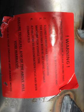

Oh, @TomsFocus,
Here is the DPF sticker:
What do you make off it?
Stophen.

Well, the first 3 are correct...I don't agree with number 4 though.  I can only assume they're trying to heat seal it like that...but it won't work.  There'll be too much pressure around the edges of the DPF core at a constant 4000rpm and you risk cracking the core or worst case causing a bay fire heating it up like that when it's empty.
