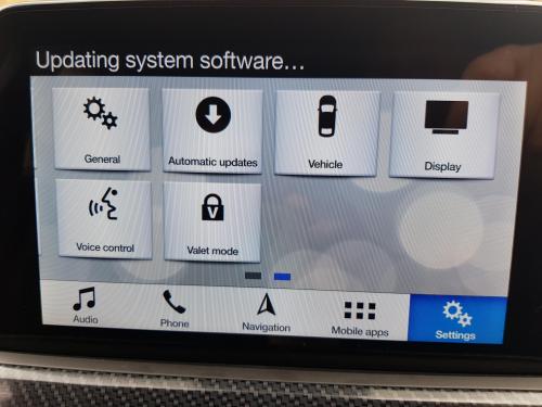

You get the updating software, top right. Sometimes this may vanish if in a screen with other info in that location.

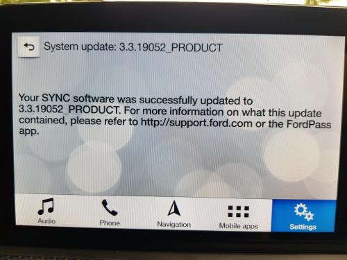

You then get the successfully updated screen, if it works.

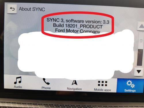

The old version.

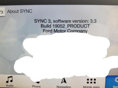

The new version.

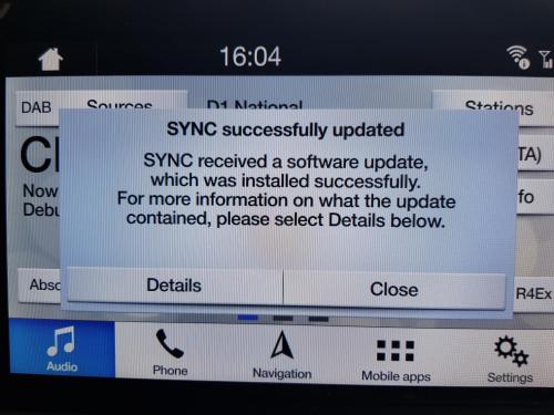

Then the last screen when you press the blue arrow on the top right of the home screen shows the system update screen.

Updated my successfully to 19052, don't remember seeing the last screen, but one about the update will install after a engine off and restart.
