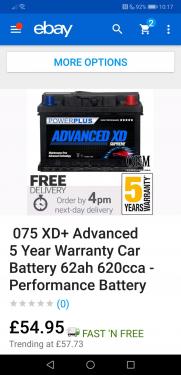

Screenshot_20190811_101807.thumb.jpg.c06a1fdba5290156196b6940dc81f62d.jpgthis this is the one I bought for my 2010 1.8 focus, it has a better cold cranking amp than the Bosch one it replaced. It was a toss up between this one and a yuassa one

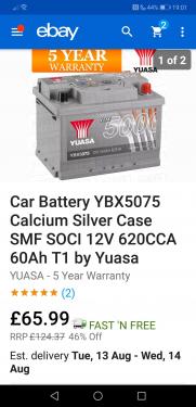

Go to the Yuasa site here Link put your reg in and see what it comes up with. If it comes up with the YBX5075 that’s what I fitted when I had mine, pretty sure the first number is the number of years warranty, so 5 years. Then just see what’s the cheapest you can get it for.
What a useful link - lots of info about my car
Bit of a shock though when I saw what battery I needed and how much it would be!

That's the battery I WAS going to buy but decided on the advanced one only cos it was cheaper and 2ah bigger
@Westville take the prices with a pinch of salt, my current car battery comes up as 180 on that site, but I got it for around 120 locally, that’s for an EFB stop/start fancy thingy.
@wilto I can see why you went for the Advanced, if the 5 year warranty stands up then it’s a good deal. I get mine locally through work, so have what ever they have in stock, which is usually either really cheap for if you’re just selling the car, or rather more expensive if you’re keeping it for a while.
