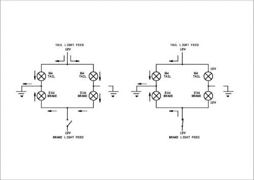

Hopefully this drawing will help you to understand how it happens. Notice that when you put on the sidelights there is a current flow through the tail light filament, through the brake filament on the same side and then to earth via the brake filament on the other side. Because the brake filaments have a lower resistance the tail light still works although slightly less bright.
When you press the brake there is now 12V to both filaments and on the side with no earth the voltages cancel and no current flows.
