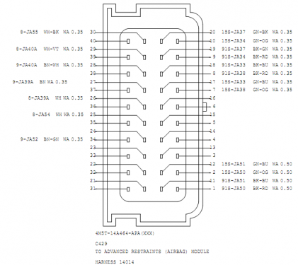

Pins 1 & 2 are the pins for drivers side curtain on the big connector to the floor harness on the control unit.

Pin-out of the harness connector is below. Pins 1 & 2 should be the driver curtain.
