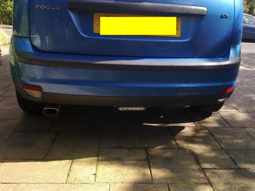

I have a spare LED DRL from another car project. The reversing light on the Mk2 is woeful, and I have already upgraded the bulb to an LED which gave a slight improvement. but still not great. I'm now considering mounting a 'DRL' just under the rear bumper wired in to the reverse light. Just afraid it looks a bit boy racerish, rather than someone who no longer has strong teenage eyes LOL
Does it look stupid?
Forgot to state, that is an old fashioned mock up as I'm an old school guy. Photo shows actual light held on by a strip of duct tape LOL
I think that looks pretty darn good actually, but also think having the one on the left ruins the effect too; but I guess I'm used to my old one having a second unit on the right when I did the mod myself with a euro lens..
I dont know here, in one regard it's great. Having a second stops people saying the didn't see your one light because they were on the angle away from the car in a car park (exactly why I did it in the first place!!) And in another it would look.. Odd?
Great idea but maybe given a bit of a struggle to work with.
To throw a spanner and all that, Have you thought about something else- I used a cheapo led pod a bit similar to that DRL you have and had it bonded on the inside of the bonnet with a fridge push-switch for activation for when I was doing anything under it. Potential?
I looked at similar for the boot too but didn't have my car long enough before someone wrote it off....
+10 rep for duct tape btw!
OMG, you just bought back a memory almost 40 years old! I hooked up (on my 1st car, a Datsun 120Y) an 'alarm' push bonnet switch to a 12v map reading light (don't think LEDs had been invented yet) so I could see under the bonnet. You also sound as anal as me too (with respect) as on my 1.9 205GTi, I ensured that there was a fog light on both side of the bumper to make it symmetrical! It only came with the drivers side one.
The mod you did using a Euro light to make it symmetrical sounds great, however, my fussiness has died down somewhat over the years, and the mod I'm contemplating is a zero cost one, as I already have the LED light, and it would just take a bit of wiring, again, no cost. I also have a bit of lens black spray paint in garage that maybe I could use to tone the whiteness of the DRL down so it doesn't stand out too much! Thanks for the feedback though, much appreciated...
I replaced the reflectors on my land rover with two LED light bars to improve the reversing illumination which was dire without them, so go for it
Have you thought about buying some cheap LED lights from IKEA to use? They are well suited to vehicle use and they do a wide range of shapes and sizes most of which will run happily off 12v supply. Land Rover users have added them under bonnet and in rear to provide more light than the standard candle supplied with the cars. They look quite stylish and not at all out of place, (You will never look at IKEA lighting in the same way now that snippet has been passed to you) :whistling:

Nice idea. Anything that improves visibility is great especially with having one crap one on the rear. Might just do something similar at some point 😃

Well, went ahead and did it on the persuasion of earlier darker nights. The most difficult bit was fabricating some custom brackets as the lights I had are 'handed' in that the lights are curved for LHS & RHS and I obviously wanted it to fit flush with the rear bumper, and the original mountings just weren't suitable. Anyway, all done now at zero cost as I had the DRL sitting in garage dong nothing. Happy bunny now...
New brackets...
OK, last photo, honest LOL Goodness that's a bright light! Will definitely help these ageing eyes when backing car up! 😎
What a difference defo will be not missed now 😃
