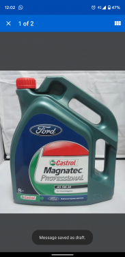

Can anyone tell me if the oil i got is the right one for my focus 1.6l, petrol,manual, 2010
CastrolMagnatec Professional Ford A5 5W-30.
The oil mentioned on the can is for 913C and 913D and I need , according with owner's manual , 913B.
I bought it from eBay and the seller said this is suitable for my car.
I already added the oil to my car
Thank you

Thank you for your reply, you're saying that the oil for 913C specs can be use for 913B specs?
Cheers
I would say so yes.  It's usually the case that a later version of the oil can be used on an earlier engine.  For instance, my old Merc's oil spec was 229.51.  Mercedes then updated the oil to a new spec, 229.52, but this was still ok to use in my engine.
