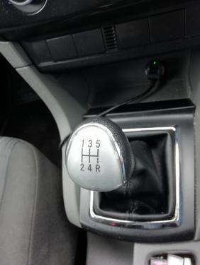

Just to clarify i didnt want to take the whole centre console out,just the silver top cover to maybe wrap it . I have just pulled gently on it and wondered is it not just clipped onto the main console and removeable if i remove the under armrest box and the storage box nearer the gearstick ? Sorry on the road at the moment otherwise id get a pic of what i mean etc.

The gearstick part pulls off from the very front nearest the cup holders work your way around it unclips you need to also separate the chrome trim but be careful it's attached to the gear gator and can snap very easily. If I remember correctly the stereo needs to come out to do the center console and the center part is attached with 2 screws either that or it just pops off but stereo gets in the way. Mines was horrid when I got the car somebody had spilled an air freshener on it or something that left a non removable mark so I just painted mines it's not the best but may wrap it at some point.

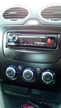

Yeah ive changed the stereo over so that part of the fascia i have managed and can remove the part with the windscreen heating buttons on.Then funny enough last week changed the gator and gear knob which was easy enough.Its just wondering about trim and how the long piece comes off and how tricky is it to remove the start button.
