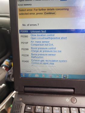

Just scanned it myself, here's the codes... Like I mentioned before the egr has been there for a while
I'd start off by checking for boost leaks, the small 90 degree hose that top left as you look at the car from the front is known for failing over time. The rubber goes hard and typically splits on the underside, it's can  be difficult to see so you'd need someone to rev the engine out whilst you work round the hoses checking for air blasting out of somewhere where it shouldn't.
A silicone replacement can be purchased off ebay for less than £10 and will last longer than the car.  The above issue isn't the only cause of the DTCs you've got but it can cause those codes and if it's the cause it a cheap/easy fix.

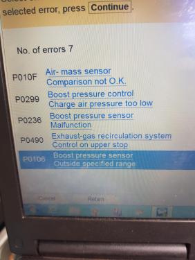

So I've just taken it to a garage and it has 7 fault codes
The MAP seems like the next most likely culprit I guess.  I'm not sure if there's a way to test it with a multimeter or whether you'd just have to replace it and hope it's the root cause.
If I remember correctly, the MAP on this engine is a little rectangular (usually Bosch) thing bolted to the top of the engine that has an electric plug connector at one end and a little (thin) rubber hose coming off of it.  The thin plastic hose is really fragile so it's easy to damage it, which would cause a small boost leak, I know because I broke mine a couple of years ago! :wallbash: I can't remember what codes it triggered but the engine wasn't happy until I fixed it.
Thanks for your help bud, I believe it was the map, the sensor wasn't connected properly and it's been running well now for 3 hours, fingers crossed that I don't see this issue again 🙂
