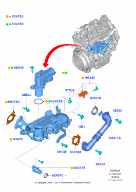

Pic of EGR on the DV6C (mk3) is below, from:
https://ford.7zap.com/en/car/53/no/17/1553/15430/67111/
I seem to recall iantt saying there were very few problems with the EGR on the mk3. It is much better than the mk2.
I suspect that remapping would be needed with the mk3 to avoid error messages or poor operation. Even on my old Mk2 Lynx, the ECU clearly knows when the EGR is blanked, it drives the valve full open yet still can not see the required flow. It does not complain about it to the extent of an error message, but I think it operates in a sub-optimum way, with worse fuel economy. When my EGR was misbehaving (electrical problems in the actuator), the car was much better with it blanked. But with a good, working EGR, it seems to be better with it unblanked. Top end power is not affected by the EGR, the valve closes anywhere near max power.
As for carbon build-up, I still think a little bit of the Italian tune-up is a better answer. A nice bit of up-hill dual carriageway, hold back the speed until on the gradient, then open up fully in top gear for as long as possible while staying (more or less!) legal. Not every trip, just every couple of 100 miles.
If re-mapping is involved, you are entirely in the hands of whoever does the mapping. I doubt if Ford gives any assistance in this, so where they get their information from is a mystery. And it seems to vary a lot. I would leave it alone unless I had good reason to suspect there was a problem, to be honest. Unless maybe going to a reputable company for a power upgrade, then I would listen to their own advice. Power upgrades (with a warranty of some sort) need the best from an engine, they should be better able to give unbiased advice about the EGR.
