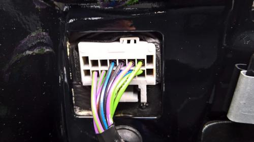

OK, the next project (and I've lost my notes hence the post) is to fit some power folding mirrors, especially since one of my mirrors has already been clipped by a numpty. Does anyone have the part no's or a link to a place I can buy a pair. I have the global opening/close so I assume I have the necessary wiring as below. Also is it necessary to have the driver controls with the power mirror over-ride ? If so, I'll need that part no. as well,

Check you have them pins going from the module to the mirror you’d also need a new window button trim with the button to fold on.
Hello I put folding mirrors on my 3.5 focus and the part numbers and fin numbers are fin no 2171.873 part no bm51 17682rf and Fin number 2171.877 part no bm51 17683rf
Thanks all for the info, now off to see if I can find any. The wire diagram is going to be useful for the door lights
