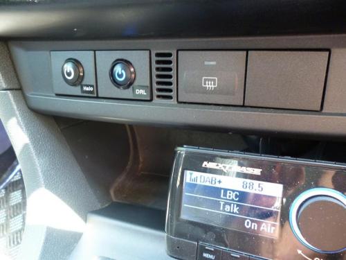

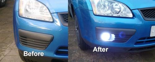

I installed DRLs on mine... here they are.
And installed separate switches for 'halo' and centre LED (They come on automatically with ignition, but can be switched off selectively)
Thanks for the info and pics, the halo/fog looks super, nice job with the install ,would you have a link for the lights and switches please. Thanks

Okey dokey, the first thing you'll need is a LHS & RHS foglight holder, I picked up both for a tenner off a breaker. You may just drill a 3" hole in the original blanking plate, but, I think personally they'd look rubbish!
This is the seller of the switches...
This is the seller of the lights...
Best of luck, and post some photos when all done 😀
