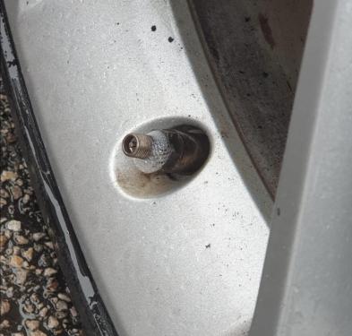

I have a 2015 and the rear is a weekly event for me.. I know I need a new TPMS, a la:

Wirey, looking at your pic, that's not where I figured to leak to be.
I thought it was the seat of the valve, where it exits the alloy?
Same here; the front is the valve needle itself inside the barrel, this back one is exactly as pictured and the other front is a bit flaky as well, I'm wondering if I that one being by the alloy itself as you mentioned and to top it off and have a full house let's say a puncture in the other rear knowing my luck lately..!
But in seriousness theres a huge lump of rubbery stuff sealing the alloy and the valve where you mention, it's probably the stronger bit really. The valve stem where the bolts run are probably the weakest part as they have a type of thread lock 'gunk' that goes a little brittle over time with age and weathering. It shakes loose then and gets little micro gaps in where the air escapes.
