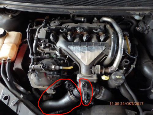

Think I might be getting somewhere with this... Drove home earlier from work, car cut out after starting so restarted with a little throttle and was okay. Pulled in at the car parts place and nipped in 5 mins for the Camshaft Positioning Sensor, got back to the car and started it which went well. This time though, there was next to no throttle response and I couldn't move the car. I could tap the throttle and the revs would move from ~800rpm to ~1000 rpm but pushing the pedal any further did nothing -- right to the floor even. Restarted and had the same issue. Restarted again and this time okay. Got home and restarted the engine again with the same issue... no real response from the throttle pedal.
Went into the engine bay and while looking for splits in the pipes, I noticed that the end of (what I presume is) the intercooler pipe was a garbled mess and was folded over on one side with a jubilee clip holding it on. I slid the clip off and around 15-20mm of the pipe fell off. I unfolded the pipe, pushed it up as far is would go and put the jubilee clip on tightly. I also took the air intake temperature sensor out and cleaned all the oil off it. Car started fine after that. Left it and hour and again it started. Real test is tomorrow morning...
This isn't a photo of my engine bay but it's the same engine. The sensor and pipe I'm referring to are attached to this post. The second photo (of the two pipes) shows the pipe I have at the top (plastic?) and the one which seems to have replaced it below (rubber/silicone?)
I just changed that bottom pipe on my one last month it had a little spit in but car was running ok still just would not boost full it never cut out just a bit slow off mk in 1st but got pipe done all ok it was about 20quid from ebay
