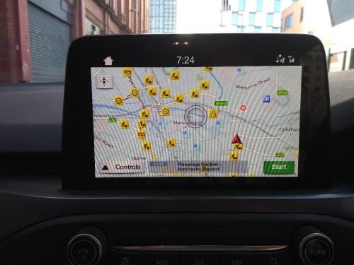

I can however show you what it looks like on the map screen when working.
Glad I don't live where you do !
