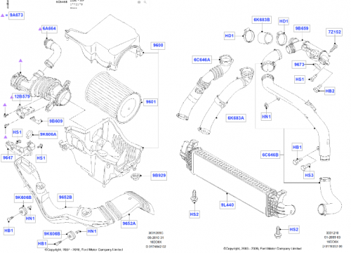

I have tried to check the hoses freom the turbo through the intercooler and up till the engine intake and i can't find any cracks or oil build up there.

boost leak any sign of leakage from intake system after the turbo or intercooler leak if fitted

I have tried to check the entire intake system for leaks, but i have not found any leaks.

Boost leaks are a git to find some signs can be slight oiling around joins excess dirt build up along pipes. You can use a heavy smoke source to see if you getting a blow from the intake system, but it need to be heavy smoke other wise you won't see it there was some i saw a while ago with dye in as well so you could use a uv source, other tricks are using a mist spray (be careful flammable etc) around the pipes and joins to see if you have air coming out or air being drawn in the engine pitch will change for a second or two.
Side note check for weak jubiles or spring clips on the pipes they could be leaking under pressure.
