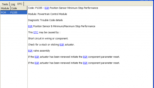

I have reset the codes using Forscan after running some self tests and the code I cannot clear is P1335. This didn't appear before and I believe it relates to EGR looking at the screenshot. It has only appeared since I reset the EGR Valve Adaptations. It also now states "Engine Malfunction" on the screen.
I've located the EGR and can see where it is bolted together and plugged into a wiring loom. Do you think it's worth taking out and seeing if it's gunked up or stuck open? Would this create blue smoke?

Were you able to reset the EGR adaptions or did that procedure fail?  I would have assumed the EGR to be mapped out along with the DPF really, and if so, trying to run service procedures on it may confuse the PCM.  EGR adaptions should really only be reset when a new (or cleaned) EGR has been fitted.  I know hindsight isn't helpful now though lol.
Would also be worth checking for a blanking plate if you can see the EGR, it'll be about as think as a pound coin so easy to spot between the EGR.
A stuck open EGR (if not blanked) can cause smoke, but would also cause a noticeable lack of performance, particularly at full throttle.

I know I realised after I probably shouldn't clicked that test after lol. It did run fine though and reported the test as complete when done. It was after that I've had the "Engine Malfunction" message. I'm doing a 20 mile trip later so will see if it clears (wishing in hope!)
I couldn't see a blanking plate at either end of the silver pipe (where it terminates to a diamond shape) so I'm presuming it hasn't been touched. The performance is absolutely fine but quite smokey under heavier acceleration but I guess they all are at this age.
I'm going to book a half day next week when there's some sunlight so I can remove the valve and have a proper look. I'm hoping to find an absolutely caked up valve to be honest.

Had a look inside the EGR and there's some soot there, but it certainly doesn't look blocked. There were no blanking plates either. I've done all I can testing and inspecting to eliminate anything obvious. I rang a recommended garage and they said it's a can of worms and would be expensive.
The engine malfunction message is still present after resetting the valve adaptations so will need to figure out how to get rid of that. All I can do after that is give her a clean and get something significantly smaller and cheaper on finance 😞
