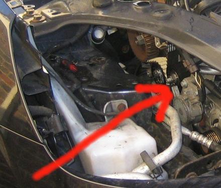

this is photo taken when I was replacing timing belt on my car 1.6tdci fiesta. I took some photos as evidence of it being done as proof if selling the car. Even if someone says it's done and has a receipt for a part, it does not prove it. the whole size pic showed the chassis number in it as more proof. (the car was actually sold to my brother later on so not needed as evidence.
Anyway I released the tension on the tensioner by putting an open ended spanner on where the red arrow points to and turned towards front of car. clockwise if facing the in the direction of the arrow. obviously you need to be careful it does not slip off.
